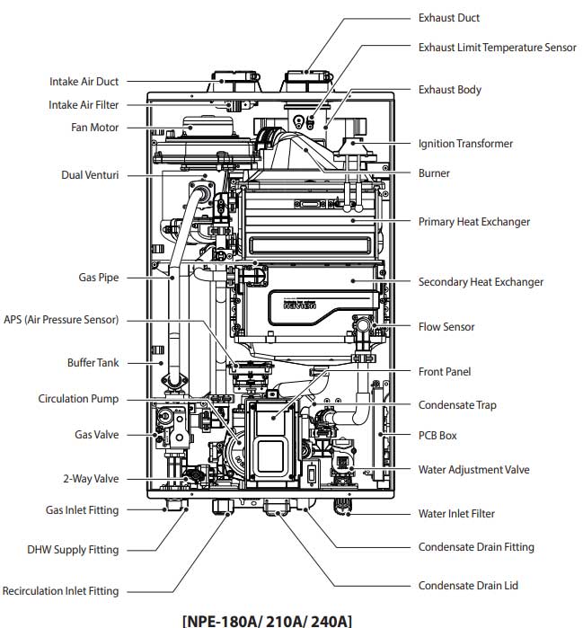

Hello everyone,
I am considering getting a Navien tankless water heater. Originally I decided against tankless because of the maintenance issue but these Naviens claim that they don't require any maintenance. My plumber is the one that told me about them. They also can be vented with PVC instead of stainless. Pretty neat. Anybody heard of them or has used them. Thanks

There's something to that- it'll be awhile before NavienAmerica is put to the full service test. But the designers & manufacturers behind it aren't 3rd rate slouches.
Scuttlebutt has it that the engineering resources behind the design are former Takagi (a top-end Japanese tankless manufacturer) guys working for the well estabished Korean boiler manufacturer. The condensing design is relatively new, but they're way up there on the true-efficiency end compared to standard non-condensing versions from other manufacturers. Whether the support & service aspects are up to snuff compared to Takagi, Rinnai or Bosch et al remains to be seen. I personally know one person using it as a combination hydronic boiler/HW backup heater for his solar heating system- no problems noted, but it's been in service less than a year. We'll see.
But no maintenance? (Wanna buy a bridge? ;-) ) Cleaning the filters is important, and if you have hard water there can be scaling issues cutting into efficiency with any tankless. But even a scaled-up Navien will be more efficient than any tank except the very-top-of-the-line European stratified-condensing tank heaters (which cost significantly more.)

We install over 100 navien a year!!
To who ever commented about the Navien tankless water heater system.
It is all true. Best system we have worked with. Not only do you get stainless steel heat exchangers but Dual heat exchangers with condensing technology.
The system is 16-20% more efficient than any other regular tankless in the industry.

Are you a plumber, environmentalist, etc? Our base is a solid firm number. Both systems are being used through out the US right now. Our units have been installed in the last 12 months with no call backs or problems what so ever. But if we do get call back, so what! We go, diagnose and find the solution.
Just like any equipment from plasma TV's to Hot water heaters. Its not always going to be perfect, maintenance free.
Navien HWH have over 10 years of field testing DATA.
The CEO of Navien now, used to be the VP of TAKAGI... and Takagi is the worlds oldest leading tankless manufacture in the world.
To me- Rinnai, Takagi, Rheem, Navien, Bosch are all wonderful tankless units that require maintenance and servicing at least once every two years.
No matter what they say- You can't get a unit HWH installed and walk away forever and not look back to check on it!
