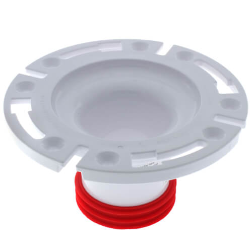

I bought a 3" flange and a 45 flange to visualize. It looks like if I use the 3" with a 10" rough in toilet, I'll still be hitting the edge of the joist. Then the fitting on the flange would be wider. (I assume nobody likes a flange that goes inside a 3" pipe.) I think 10" rough in with the 45 or the offset is going to be the least amount of hacking. The 45 looks like it would start curving away from the joist by time you get through the two layers of subfloor and tile. Unless I am just totally missing something
41,382
4,990
Inside 3-inch flange can be good, but there is less potential for mounting the toilet off center.
is a long tail 3-inch inside flange that is good. Sioux Chief 888-PM.
is inside PushTite. While it has a plastic ring, it could be replaced since it is not glued.
In the same category, https://www.oatey.com/products/oatey-twistnset-replacement-closet-flange-1098867162?upc=038753436548 there is the Oatey Twist-N-Set Closet Flange
Zelbrew
20
Jeffersonville, IN
I was kind of thinking that I might use one of those temporarily until the final floor is finished. However, I don't think it solves the problem of the joist being in the way. It looks like even with a 10 inch offset I will still hit the joist with the pipe. It is kind of hard to tell right now because my understanding of where the joist is is based on exploratory holes drilled into the floor to find the joist.
If I can get 3" pipe straight up the side of that joist, I could trim away part of the top of the joist to make room for an outside flange and be well within the rules for notching. Could sister on the other side of the joist for good measure if there is a question.
In any case, I thought the consensus was that reducing a 3" pipe down further by inserting one of these flanges was a bad idea.
Most new toilets have a 2" trapway, dropping into a 3"
The bend below is going to be 3", so I don't see a problem with the inside pipe closet flange on the vertical.

So, in your opinion, if I have clearance to get a 3" vertical next the joist, would it be better to use an inside flange than to use an offset (which would fit outside the vertical pipe)? The inside flange would save me from having to greatly alter the plumbing later when I raise the floor.
BTW, referring to questions earlier about the offsets, I think they all claim to be able to pass a 3" sphere.
