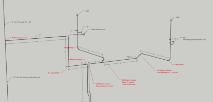

Here is my situation, and hopefully this drawing makes sense, and you can read it fine (plz, let me know if some info is missing, it's a 3d drawing, so I can rotate it and take a snapshot at any angle).
When we bought the house, the kitchen sink was connected to 2" waste that had a vanity sink connected in the basement below, so that sink in the basement was wet vented.
We are changing kitchen layout, and are moving the main sink, and introducing an island with a secondary sink, and we actually couldn't vent it because of windows, etc, so will be using AAVs.
Primary and secondary kitchen waste pipes I can run between joist, and then I would need to drop and make 90 degree turns to where the waste can go down further. Everywhere the plan is to use 2" pipes, P traps would be 1.5". BTW, the main sink will have a garburator, and a dishwasher hooked up.
A) from secondary sink, to introduce the drop in waste pipe I was thinking to use long sweep, turned/tilted 45, and then to connect to lower horizontal waste pipe using 1/8 turn. OK? not OK? Am I missing something in there?
B) from the main sink, to connect to horizontal waste pipe the idea is to use a long sweep, again, tilted by 45 degrees, and connect that to wye-t laying on its back. Am I missing some gotchas in here? I'm not sure how I feel about that wye-t on its back, considering it's a waste from a main kitchen sink. On the other hand, my space there is super limited. Maybe I'm missing something.
C) The idea is to have some sort of relief vent for kitchen sinks' waste, and hopefully wouldn't need to rely on AAV as much? The worst case scenario: kitchen sink is filled and the garburator is ON speeding up the dump while the dishwasher is dumping its load as well - in that case AAV would kick in. But under normal use, since the sink P trap is 1.5" that is connected to 2" waste line, would it help to have that vent loop, or is it just a wasted effort, and might actually cause more trouble than to solve anything? I do know that max distance before being vented is 8' for 2' pipe with when pitch(drop) is 0.25"/ft.
From my ignorant point of view, the loop would minimize chances of spilling kitchen sinks "goods" into the vent for the sink in the basement, and maybe would decrease chances of opening AAV vents in case there is some pressure drop from some "other activities" in the main waste pipe, like flushing toilets.
Help, please?

I didnt want to read all that you wrote so sorry . but your drawing has this oddball island vent whatchamatalkinbout thing just eliminate that nonsence with a vent on the left and a drain on the right I see no issue that you could be improving on
tomasb
British Columbia, Canada
Is this what you are suggesting?
The issue drilling into joist there because I'd be drilling technically in "no-drilling" zone in joists.
Option #1
Option #2: Or is this something like this? Similar as Option 1, just moving basement sink's vent into across joists
Option #3, I think this is the winner:
What's wrong with the drain on the right? As I mentioned -the small sink's drain goes in between joists, then it has to drop bellow the joists.
Or, did you mean that new vertical which seems like a duplicate to existing drain, going to the basement? In which case - is it ok to wet vent the sink in the basement with all the crap going from the kitchen sinks from upstairs?
The elbow dropping to the 45ell at a 45 would be considered Horizontal to Vertical and only needs to be a Med 90.. not a long sweep.
The elbow dropping to the Wye at a 45 would be considered Horizontal to Vertical and only needs to be a Med 90.. not a long sweep. The wye on its back is perfectly fine and is one of several ways drain pipes have combined for decades if not hundreds of years.
Vents should not connects under the flood level rim of any fixture. If for some reason your drain clogs, the cross over vent will allow the waste to flood over and into the other vent and likely prevent you from knowing your drain is clogged. There is no plumber here who has ever installed such a loop to provide any evidence that it works or doesn't, but no code allows for this type of connection between vents. The venting from a fixture on a floor below must connect at least 6" above the flood level of the fixture located on the upper floor. The AAV is designed to open when there is negative pressure on the valve. They work fine.

pipe on right is a drain disconnect it from the vent period. the drain will go to the 2 sinks and will never reconnect in any way with the vent. option 1 , 2 or 3 are no good

Thanks a lot for coming back with this detail response! To educate myself further, I'd like to ask some follow up questions.
Since you used "only needs to be" instead of "has/must be". The way I read/understand it, "only needs to be" would mean "at minimum", while "has/must be" means exactly.
I have space there to install long sweep. and thus, my thinking was - longer means more hydrodynamic, thus better? Easier to snake on longer turns as well?
Is there a reason (e.g., code restrictions, increased risk of clogs due to faster water flow, or other factors) why a long sweep fitting couldn’t be used in a horizontal-to-vertical configuration for a branch that is vented, in this case using AAV?

That's all what I could find. I think it's talking about medium sweeps, and where they *can* be used. It does NOT prevent using higher radius ones, so long sweeps should be good?
Ok, thanks for confirming, I'll stop worrying about this, considering that I have no space to do anything else in there anyway.

Thanks, here is the option #4, cut in pieces to make pictures a bit more readable, the last one is the whole thing.
I have updated sweeps as per @Tuttles Revenge comments, thought I haven't found anything in code preventing long sweeps in there in this particular case

Absolutely NO way you should or need to connect that drain to the vent under the flood level of the upper fixture. If you want to add a form of relief vent for those kitchen drains, it must connect above the flood level. There is no code reason to add the vent, but there's no restriction against it either. It just can Not connect under the flood level.

That's not a wet vent, it's just an illegal unvented fixture. Since you are contemplating AAVs upstairs, the simplest solution is to vent the downstairs vanity with its own AAV.

I see no issue with his plan to tie downstairs lav vent to laundry vent. provided easy acess I wouldnt want to open walls unless I was already doing an extensive amount of drywall . So an AAV might be a good idea . but its that mess Ive mentione 2 or 3 times now that needs fixing and all of us have mentioned it to him

Your understanding is correct. Medium sweeps are the minimum allowed.

Yes, any place that a Med Sweep can be used, a Long Sweep can be used as well. Using a shorter sweep in certain instances has an advantage in saving inches which can be critical for certain applications. But not every place a Long sweep must be used can a Medium sweep be used except for those points that you found in the Canadian code. Their exceptions for elbows at fixture trap arms is common practice in my area, tho not permitted by the UPC which we use..
