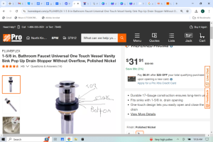

Hi everyone,
I'm almost finishing the project of remodeling my Master Bathroom (it has been a challenge for months). This week came the plumber to install the 2 faucets/drain assembly kit on my Vanity. At the beginning everything seemed well connected and no leaks. But actually there were, specially when I fully test it by filling the sink completely with the stopper closed. He has come a second time, and he told me that must be a bad quality red washer that goes in the connection of the drain assembly (metal) with the plastic pipe that goes to the P trap (Picture 1).
After some tests I did by myself again, I could notice the water was actually PONDING there in that junction, so actually it was coming from an upper part (Picture 2) specifically under that big nut. I sent that picture to the seller from Amazon (where I purchased these 2 kits/assemblies) and the seller says this: "it seems that the opening of your ceramic sink is not flat, causing water leakage" and he suggested me as a solution what is shown here on picture 3 (to use "anti-leak" putty on sink opening). My question: is this a good troubleshoot for this leaking ? I mean, before calling the plumber for a 3rd time to come again to check this, I wanted to be sure of this response from seller, and discard the option that the drain assemblies are actually defective. I'm the owner the the property, I'm not a plumber, but I just wanted to understand the mechanics here. By the way, during the tests I did, I was placing my fingers around that white plastic/rubber that touches the ceramic bottom opening, and it was dry. Water was right under the big nut.

I'd probably agree with the seller's recommendation unless your sink has an overflow. Water getting into the overflow would bypass that seal.

That is the location that typically leaks on a bathroom sink. The issue is that the rubber gasket has to seal against the sink on the flat part and also against the brass vertical portion at the threads. Many plumbers wipe some pipe dope or silicone against the threads where the gasket will make contact to fill the voids in the threads that the gasket can't make up.
Most manufacturers use a finer thread than those pictured which allows the gasket to seal easier.

Yes it has an overflow, and actually the leak happens more noticeable when water reaches the overflow in the full sink test.
Plumber is coming today for a third time. I will mention him this, which I guess will improve the contact. Thanks

From the pictures, it appears that the donut gasket is missing on the bottom of the sink

I just had a similar issue, but but mine was an overflow sink, so it had a thick rubber seal underneath then a plastic washer, and then the nut. However, water was leaking in the exact same spot you indicated. Apparently, if you over tighten the ones that have the thick rubber seal, you can slightly deform it and the water will leak past the threads. So I would recommend liquid teflon, or teflon tape, if you don't have the liquid where the washer and threads for the lower nut will be. I also did not over tighten it this time and no longer have a leak.
