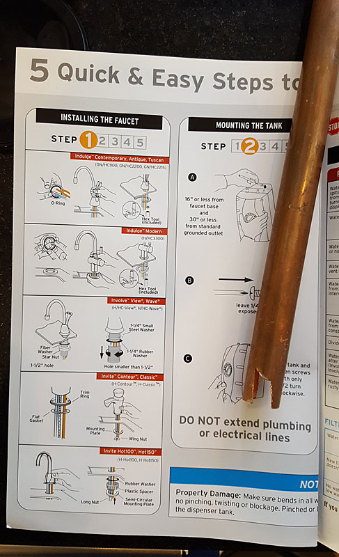

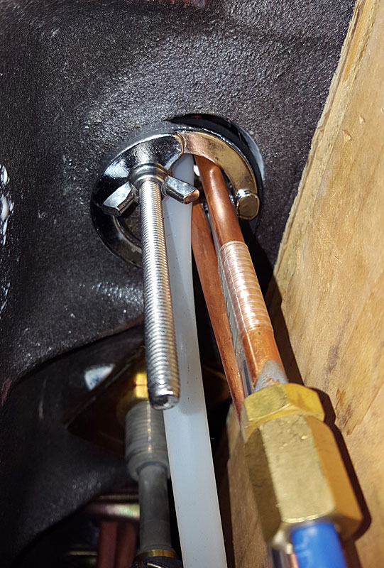

Insinkerator has a new Contour model Instant Hot with a different installation method than the old twist top dispenser. Instead of pulling the cap and using a screw driver to install like their previous model that I had installed for years, it switched things up and went with a small wing nut under the countertop. I found this arrangement very hard to tighten with the little amount of space and having to do so with just the tips of my fingers.
I tightened it as tight as my large fingers could, and the top when I twisted it would still move.
Since my hand was too large, and my fingers too weak for that position under the sink, I made a tool to help me get more leverage on the wing nut. I took some 1/2" copper from the truck, and cut two notches at the end with a hacksaw. With this tool, I was able to use both hands, wearing rubber gloves to cinch that puppy down. Now that dispenser on top isn't going anywhere!

I have one of these Ridgid #2001 "Plastic Nut Basin Wrench". They work well on wing nuts (of reasonable size) and of course typical
winged plastic mounting nuts. Ridgid now has an updated model now which I can't vouch for.
