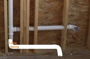

See this and say why it does not work for you.
index.php
There is a limit to how long that trap arm can be.

Eweeneek1, I re read your post , inspectors generally dont like what you suggested "offseting a vent horrizontally while less than 6 inches above the floodlevel of the sink " basically we usually shoot for 42 inches high minimum.
but as in Reach 4 photo posted you could in a similar fasion presumeably under a cabinet penetrate floor outside wall to side of sink that has no obstruction like a dishwasher point santee and trap arm toward sink against outside of wall with room for drywall vent can be offset with a couple 45s into the stud cavity no need to be above flood level when using a 45 . Easy as Pie!

The photo Reach 4 shows would work, but there is that 4x12 beam under the wall. Jeff H Young describes a similar solution. Not sure if I understand it completely. Would I move the drain and vent outside the wall and then use 45s to get both back in the stud cavity?

Maybe. But you can also run the drain line through the floor of the cabinet. Where you want it out of the wall, bring it into the cabinet.
So below the santee, you can go horizontal, except that vertical to horizontal transitions must be long sweeps or 45s or combos.
You should really try your own drawing or photo. The words are not as easy to follow as you think they are.
