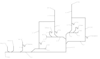

Good morning All,
I am looking for some input on my vent and waste schematic. I am building my own house, I am not a plumber so would like you alls take on what I would like to do. I have attached a photo of what I have. Just trying to get an over all picture before I get into the details. I live in wild west of Arizona, the inspector is very relaxed, just about gets out of his truck with sandels on, were under 2018 International Plumbing Code.
Couple things I am stuck on:
1 - I am looking to have as few roof penetrations a possible small roof and putting solar panels up but I dont know if I can combine vents like this
2 - The kitchen sink is under a window on an exterior wall and the inspector said I could use an AAV instead of drilling through the king stud, wanted to see if this is the best solution
3 - Lastly on the upstairs wet vents my water closets are inbetween my shower and sink, before I have run the lav of the shower branch before it meets the w/c branch to wet vent; but with the tight space this isn't really possible, not sure I can run the lav with vent like I have it in the schematic.
Thanks for the input and if there is more I should change let me know. Ryan

If you join the 2-inch lav drains to the shower trap arms before joining the toilet waste, that will make the wet venting right.
You can use an AAV for the kitchen, but the other way is to run the trap arm to the left or right to pick up a dry vent to the left or right of the window. How far is it to the left or right side of the window?
wwhitney
7,219
2,050
Berkeley, CA
1) Combining vents is fine. If you have an attic space, you could combine the two 2" vents you show going through the roof into a single 3" roof penetration. If you get significant freezing weather where you are, it is normal to upsize each vent to 3" as it leaves the thermal envelope to reduce risk of frost closure.
2) If you want to avoid drilling the window king stud, then the two options are to go around it (route the trap arm in front of the king stud to a san-tee not under the window), which would take up more cabinet space, or use an AAV like you said. [There is also combination waste and vent, but that is more esoteric and acceptability varies by jurisdiction.]
3) No, the wet vents are not correct. For the drainage from the dry vented lav to act as a wet vent for other fixtures in that bathroom, you have to join it to the shower or WC first, and then the combined lav/shower (or lav/WC) joins the WC (or shower).
Also, the way you've drawn the shower make it look like the trap arm turns down before being wet vented. That is not allowed; the connection between the shower trap arm and the drain acting as a wet vent is the vent connection for the shower trap, and that vent connection must be within 2" vertically (maximum 2" of total fall) from the trap outlet.
Cheers, Wayne
