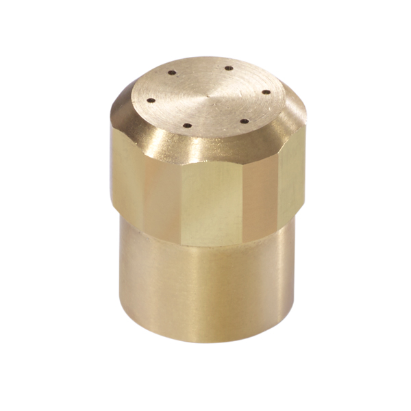

I have a mop sink that I had installed in my laundry room. I had it installed at waist level because I wanted to use it for bathing my dogs and cats at home. It's great, but I can't stand that there is no way to plug the drain, as it has the standard mop sink/shower-type drain. The outer dimension of the drain plate is 5.25" with a 1/2" depth/width where the black rubber gasket sits, then a 2.25" PVC pipe in the middle (see photos). Is there some way that I can obtain an adapter so that I can use a standard kitchen sink drain after I cut the PVC pipe to the correct length? ALSO: I had a commercial faucet with pre-rinse sprayer installed, but the head only sprays a narrow stream. Do you know if they make exchangeable heads with a different spray pattern for these things? I hate to have to replace the entire unit, as I actually like the amount of water pressure it has. (Please see photos in order to understand what I'm trying to convey.)

Likely you may need to diminish the sprayer volume, and, you will want to use a different Krowne pre-rinse nozzle like MODEL 21-189L:

The one I found on Amazon just happens to be the right size, so I won't need an adapter, but thank you!
