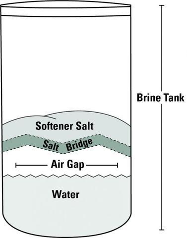

I saw in your previous post that you were concerned with potential salt bridges, which I suspect is why you have been choosing to not completely fill your brine tank with salt.
A salt bridge is a result of dry salt above the liquid level becoming wet and then drying out again. When kept wet, salt will dissolve rapidly, but when briefly wetted, salt will begin to dissolve, but will often clump together as a solid mass when it drys out again.
Since most brine tanks are narrower at the bottom, a solid mass of clumped dry salt can become wedged between the tank walls. As the wet salt within the liquid below is consumed, the clumped salt may then not drop into the liquid, and will usually prevent additional dry salt above the clump from dropping, so no/too little brine may be produced to restore the depleted capacity which the subsequent regen cycle is to restore. When the programmed capacity is not restored, the softener will eventually loose the ability to remove hardness which can be confusing for many owners since the softener is not delivering soft water even as it seems to be functioning correctly, and there is plenty salt remaining within the brine tank.
To prevent salt bridging, ensure the salt in storage above the liquid level is kept as dry as possible. This is why we advised to add the premixed CA solution into the brine well (~4" plastic tube) as opposed to pouring the liquid solution directly onto the salt.
