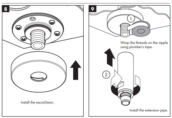

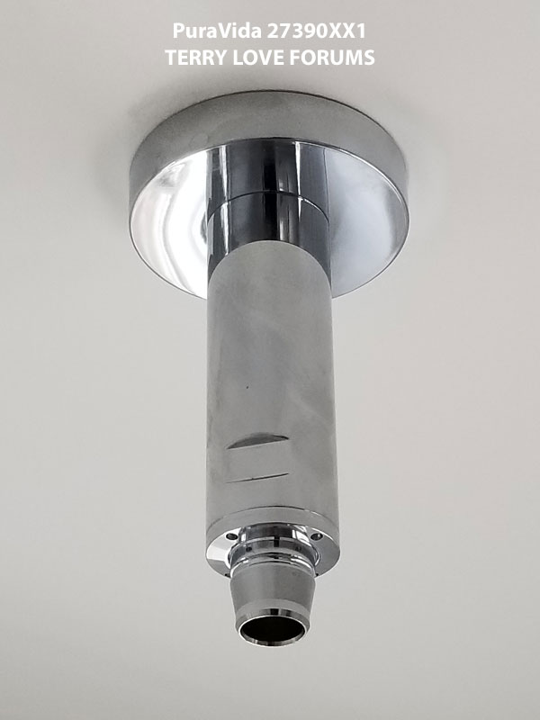

This is a large rain shower head.
It starts with their special threaded adapter in the ceiling.
The collar gets threaded into the wood backing.
The shower arm goes in.
And ready for action.
PuraVida 27390xx1

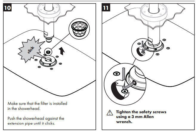

Okay, lets add these pictures too. I printed out the instructions at home, as the paper that comes with these valves are too small for someone of my age.
And you want to make sure that the Allen is tightened up. You don't want that big heavy shower head falling off.
