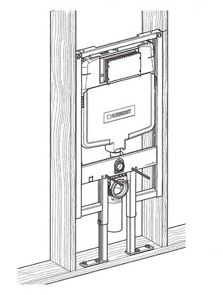

Installed one of these in our bathroom. Followed the paper and online video to a tee.
I have concerns about long term durability of the physical toilet and the wall surface.
The manual that came with stated cement board, gypsum board, etc were approved substrates.
After mounting my toilet tonight I feel like I need to modify the install. It's a 2x6 wall with extra framing added for the carrier. From there it's some 1/4" ply for shimming (left the section over the carrier continuous instead of shimming individual studs there ). Then I hung some firecore 5/8" dens armor plus (only dens armor plus I could get locally).
I feel the bottom.of the toilet bowl wants to point load the sheetrock when weight is applied to the toilet. Any suggestions on preemptively modifying the install to prevent the toilet from.crushing or erroding the sheetrock.
2) the manual doesn't state using or supplies backer nuts or washers like the commercial carriers do. Should I try to use them anyway?
3)how tight are the nuts suppose to be when you tighten down the bowl to the wall? I also assume that the bowl should rest on the plastic washers and not directly on the threaded rod.

Followed them to a t. However I've been in the construction industry long enough to see and know just how soft and delicate drywall is. It really is inferior to other wall cladding outside of initial cost (material alone).
I was considering making some sort of backer plate out of a thin gauge metal templated to the toilet. That way at least the point load at the bottom would be diffused somewhat.
The location really couldn't be reinforced with blocking since the included drain is in that location.
I feel some backer nuts and washers and so an some type of backer plate would be better than letting it go and it comprise the sheetrock down low....creating a possible leak or overall failure.

The two fat pins coming out from the carrier bear the load of the WC and the user.
The two fat pins, being attached to the carrier frame, transfers the load to the carrier frame.
The carrier frame is fastened to the wall studs and so the load is borne by the wall studs.
Nothing will move around if all is tight.
If the toilet, as the OP suggests, might bear down on its lowest point and put pressure on the wall, this suggests the two fat pins are deflecting.
Perhaps this would happen if the occupant exceeded Geberit's maximum capacity of 400 lbs.
