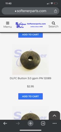

Hi,
I’ll be working on my Fleck 7000 64k unit. I recall you mention about the 2.4GPM DLFC been too small. Should I replace with the correct size Button to 3.0GPM or larger?

Hi,
3.5 GPM

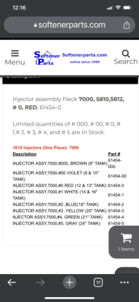

I did find some videos on how to service the Fleck 7000. While I watch all these videos, I found another question, what color of injector should I use? Does injector size matter? Looks like there is 3 different colors indicate different size of injector. I am just hoping to get all the parts needed and order them all in one time instead paying the unnecessary shipping separately.

41,347
4,985
These injectors are each acceptable, but some require a longer BD time
#00 Injector - Violet BD=130
#0 Injector - Red BD=60 to 70
#1 Injector - White BD=60
#2 Injector - Blue
I would prefer red or white. There is a good chance you have blue, which is acceptable. If not one of those, I would say not acceptable.

The label indicate the injector is #0 red which is the proper size for 12" tank, but why a 2.4GPM DLFC for 12X52 tank?
I guess I'll have to wait unit the resin and other parts arrived, then open her up to find out. This is the part I don't understand. I pay for all the services and still cannot get it right... haha that suck big time
