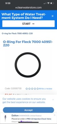

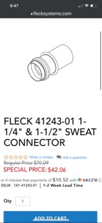

I also have a very slow leak issue from the bypass valve brass sweat connector. Probably need to replace the o ring, but I am not sure what size of o ring to get. The copper pipe is 1 1/4. I’ll upload some images. Let me know if that is the right o ring to get.
I’ll probably order 1 CuFt of resin if I need to add to the tank. While adding resin to the bank, perhaps replace the o ring at same time.

Your local full service hardware store may have O-rings and could match up the old one. I can see that ordering up the official o-ring in advance has a good advantage.

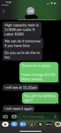

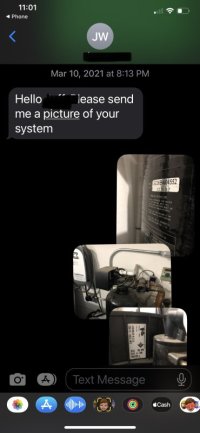

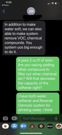

I just check the text message with the service guy. I’m sure he know the tank is 12x52 will need 2 cuft of resin. Now I’m a little confuse why only one bag add to the system… I’m not kind of guy stay and watch people doing their work….
If he does put 2 bag of resin, then why the water will not stays soft through out the whole cycle? With hardness setting at 25, each regeneration I’m getting about close to 1700 gallons. Sorry, but I’m confuse now.
