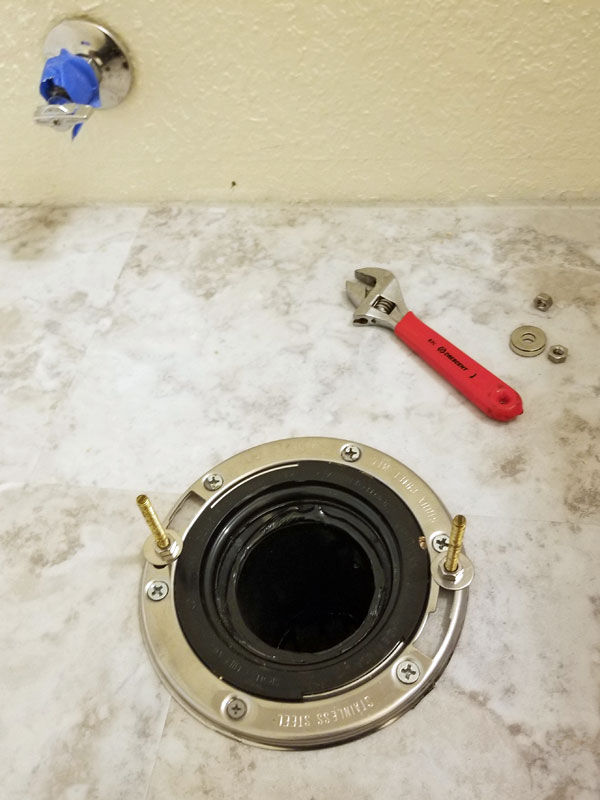

I had a handyman do bathroom remodel including new floor tile and new toilet.
The toilet installed was defective ( not his fault) so Kohler has sent a new toilet .
Now, when I removed the old toilet, I found that one flange bolt was spinning.
On inspection, it looks like he made a bad tile cut and so the bolt has no tile below ... it is hanging on air and he put it in place using a plastic washer.
Question --
Do I need to remove the flange put a base and out it back
Or
Can I use a nut on the flange to hold the bolt and then put toilet and another nut to hold the toilet ?
Measured -- the nut easily passes through the hole in toilet base.

I always bolt the closet bolts to the flange.
Just make sure that the closet flange is secured to the floor.
This is a strange picture, there is a flange below all of that, with some spacers and then a second flange over that one. Even though there are no visible screws in the picture, they are all below that, below the white spacers.
And this is how they normally look. Again, the closet bolts a secured to the flange.

Please find attached.
I have taken pictures of both the bolts ?
One, you will see has a white layer under the bolt -- that is the tile and the bolt is sitting on tile
The other one shows black in the hole . Here there is no base for the bolt to stand. I inserted a screw driver and it goes about 3" below . I can possibly pour a concrete mix through that tiny hole but apprehensive I might mess up .

As long as the bolts are held solidly, that's all that matters.
I would not fill the slots, they all have those slots.
It may be that you have a flange even lower down, that looks to be a repair flange that you have.
