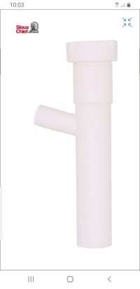

Dishwasher Tailpiece has stem too low after new undermount sink and granite top install

I agree with Wayne. It's almost definitely the wrong part. That is a tailpiece extension. He needs a flanged tailpiece with wye branch inlet.

My photo clearly shows direct tail piece with DW stem. This is directly attached to my sink strainer. Again I really need a tailpiece with a higher stem. I saw someone mentioned brass. I may check that out. This is currently the best option I have and still be able to use my sink and dw.
I'd love to see someone post up a solid solution. I'm all ears. I'm even considering fabricating my own one piece solution. Is there any custom options out there? I could make the whole piece without and slip fittings or corrugated pipe. Just a threaded tail piece and slip fit for the wall.
Shit maybe I just put a small sump pump under the cabinet.
But your photo looks like the second picture below (slip joist wye with an extra little flanged tail piece), rather than the first one (direct flanged wye). Clearly the second design forces the branch inlet to be lower than the expanded portion at the top of a slip joint wye. Of course, that doesn't necessarily mean the branch inlet on a flanged tailpiece is going to be higher like you need. But if you look at a bunch of flanged tailpieces, you can try to get the highest inlet that's available.
After you do that, if necessary the other thing you can do is use a reversible p-trap, which will make the trap seal depth 4" rather than 2" and raise up the outlet. Definitely a second choice option, but better than the corrugated option.
Cheers, Wayne

What's the part number of what you have? It looks like it should be higher by the width of the nut.
What Wayne is referring to is this. Which is flanged on top. Yours has a flange below the nut.

Nope. I have the top photo. Directly connected to the sink drain
Be that as it may, the particular design of your wye tail piece (the expanded portion between the nut and the branch inlet) looks like the wyes that are slip joint only, so perhaps it shares some design lineage with such branch wyes. In which case a clean sheet flanged tailpiece design, such as in my first picture today, or my original brass picture, could gain you some height on the branch inlet.
