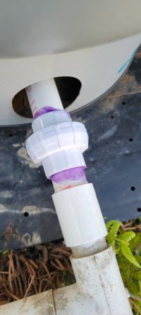

Ideally the pressure switch would see the same pressure as the pressure tank. Looking at your photo, I am not sure where you would cut in a tee to tee off to the pressure tank.
Maybe move the pressure tank back, and glue a tee onto the cut pipe. If you add a union in there, you could replace the tank more easily next time, but that should be years and years.

Hello again, my bladder pressure tank just kept filling with water very slowly until it was basically fully waterlogged. I just kept turning the pressure up on the switch to make it past the Florida hurricane and fortunately it did. I was also fortunate enough to replace my 20 gallon flexcon challenger with a newer and bigger version of the same tank that a family member just had lying around. I'm hoping this will finally fix the problem I've been having, I went ahead and precharged the tank to 38psi and turned my switch up to 40/60 from the 30/50 it's always been. I will attach a photo of my work and hope it is okay enough to last, also will be putting a cover over the setup to protect from the sun. (I used a union fitting that someone mentioned on this thread, it seemed like a good idea)
