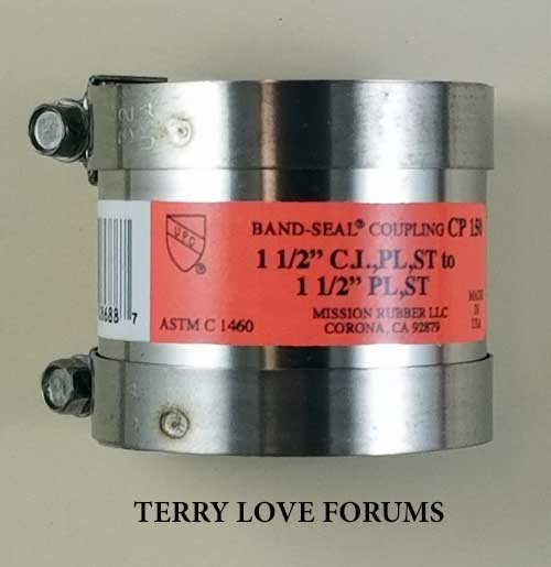

It's too bad you can't bring 2" over there from the 3" stack in the basement. For copper to plastic, they make a shielded coupling that has copper x plastic on the rubber insert. The metal wrap keeps it aligned and straight.
Like this, but make sure you have the "copper x plastic" sizing.
Second pic not easy for me. Pipe from basement is in center. First pic I would use a Fernco on copper,short pc of pvc,then wye to split....... and Fernwood at top to attach 1-1/2 pvc back to copper stack (.pic 1.)
Would it be possible to to use Fernco at bottom to short pc 2" pvc to inlet of double fixture fitting, pvc pipe and the Fernco back to copper stack?(pic 2)
