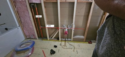

Looking for the best way to convert old copper single vanity to a new double vanity.
replacing the stack from basement utility room below to ABS from the copper to just below the vent tie in.
SanTee to first vanity (23"), horizontal SanTee for first vanity, elbow at the end (55") for second vanity.
was going to do 2" abs, then reducers for p traps under each sink.
does this make sense/code, or is there a better way.
Located in Canada.
