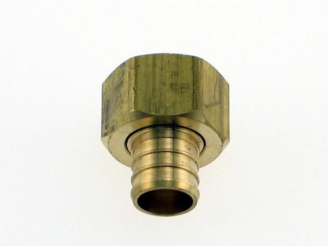

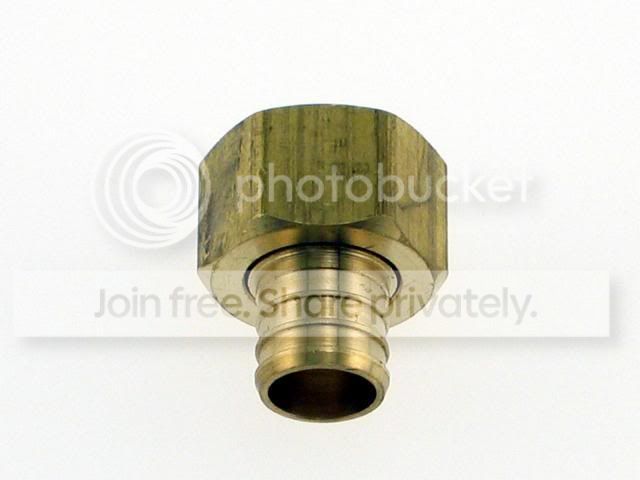

Great site!! I'm a builder working on my own bathroom addition and need some help with a shower valve installation.
I am in the process of laying out the location of the supply line connections for an external Meynell thermostatic shower mixing valve, and was wondering what the best method to connect 3/4" straight thread inside the wall. I got this setup (see attached photos) from a remodel years ago and want to use it in my new tiled shower. It is a Meynell Victoria safemix thermostatic valve.
Because the valve body will be installed after tiling, I will have to be able to rotate the inlet elbows in order to fit the valve between them (they each have a lip that protudes inside the body about 1/8"). Which means I can't solder them in their final position. I'm not sure if that would be recommended anyway. Because the unsoldered connection will not be accessible (exterior wall), I want a connection with the lowest potential for leaking.
I was considering to either :
1. thread it into a 3/4" NPT (tapered thread) with teflon tape and pipe dope.
2. or find a straight threaded connection with a washer.
Any sugestions would be greatly appreciated. I would also love to find a link to an owners manual and spare parts for this valve. Meynell is a British company who's valve business was sold to Mira/Kohler, who are also in England I believe.
Thank you
Gregory

If you hook it up with PEX, you can use a PEX swivel adapter. It has a plastic seal rather than depending on the threads to do the sealing.
I have some old ones like this that have a polybutylene ring, but I think the newer ones have a vinyl seal.
