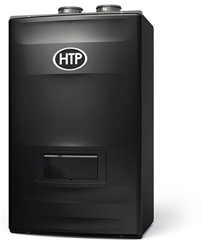

If US-made, US-support is important, consider going with HTP's UFT series, which have stainless fire-tube heat exchangers and 10:1 turn down ratios. The UFT-080W (also sold under a Westinghouse nameplate as the WBRUNG-080W) has enough high-fire output for 19 out of 20 homes in the US, but modulates down to 8000 BTU/hr in, ~7600 BTU/hr out, and can serve a ~35' baseboard zone at condensing temperatures without cycling. The lower-head heat exchanger means it can be pumped direct in most systems (no primary/secondary), saving on hydraulic separation plumbing and the extra pump. It's also designed with a separate port and internal control built-in for serving indirect hot water heaters. (They're relatively inexpensive too.)

HTP UFT US Made?
Correction it's a Kiturami Korean manunafactured boiler and finished in the US.
Look at the exact cabinet and component characteristics of products offered by Laars, HTP, Triangle Tube, Noritz, Westinghouse (an HTP label) and some others. All Korean made products made by Kiturami and relabeled.
Now who do you trust?

I was wondering just how much of that boiler was outsourced. (Thanks!) At least it isn't made by VW! :)
I looked, couldn't find a Triangle Tube with the same characteristics, but the Noritz Combi, UFT/Westinghouse and Laars Mascot series all sure look like the Kiturami Homsys:
