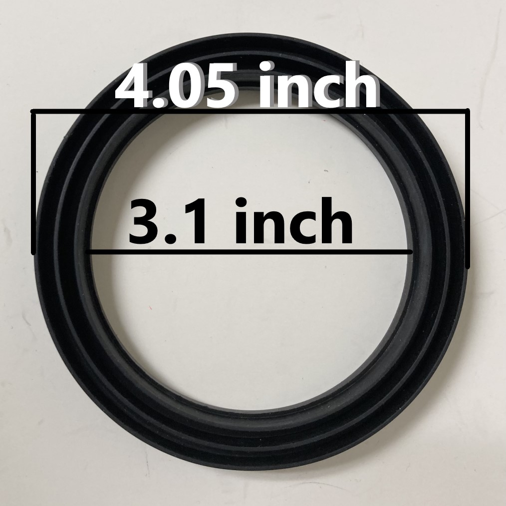

Hello all, I am reinstalling a CASE wall toilet and need to buy a new gasket seal between the toilet and the carrier bracket. I’ve seen a lot of information for the 3000 model but looks like mine is different. It is a two piece toilet (separate tank and bowl) and has 2580 on the underside of the tank lid. The carrier bracket has a 4 inch diameter hole that is 1/2 inch deep where the seal seats. The carrier drains into a 3 inch copper pipe. I was looking at the Zurn neoprene gasket but it is 5 plus inches in diameter. Seems too big to me. The house was build in 1968. I’ve included some pictures. Appreciate your time and help. Thanks.

Hello John,
Thanks for the reply but I'm still confused on what exact neoprene gasket to buy. Can you tell me a specific brand and part number of a gasket for the setup I have?
As I mentioned the Zurn gasket I found was $30 but I think it is too big. I found another Zurn gasket Model #Z1200-NEOSEAL-GSKT-4 for $79 at Home Depot. Seems like a whole lot of money for a gasket and I'm not positive it will fit because I couldn't find any dimensions.
I also found a NuFlush gasket for $13 at the following link:
The NuFlush website has dimensions and seems like it should fit but I'd like to be sure so that I can complete the job in one go.
Also, I searched for the Fernco wax less gaskets and there are a lot out there. But I couldn't find one for a wall toilet. Does it make a difference?
Any suggestions are appreciated. Thanks.

This is the most common wall hung toilet gasket we use. It should work on 3"and 4" pipe, but it didn't look like you have a common horn type inlet so I'd probably go for the fernco. Either of these will require your cleaning the toilet really well so they stick nice.

This is exactly what I was looking for. Thank you very much for the information and the advice.
