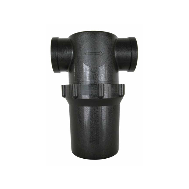

In past, another source of suction leakage has been the suction screen. We gave up on the Burcam type with sight-glass that always leaked. Now using an all-plastic type intended for pressure washers. It has just one o-ring seal. But the o-ring tends to leak. Even new o-rings that the manufacturer sent us a supply of! I am using unused o-rings from my car filters! Any suggestions for a reliable suction screen for the Burcam pump?

The strainer has given us problems because of leaking manufacturer supplied o-ring seals. For this type of application, a strainer is essential to keep out grit and seashells and protect the (plastic) internals of the pump and the Fluomac! Burcam insist on it being there! I would not eliminate it, but would like to find a better design. (my purpose oin restarting this thread)
What was the problem with the old pump, and could that still be the issue?
I don't actually recall - It may have been the seal. I bought the new pump because I found it at Princess Auto at a much lower prices than HD & HH. Bought it while I could. Original pump was showing it's age, but it still does work.
So back to my query - Anyone have good actual experience with a reliable suction strainer?

There is no such thing as a reliable suction strainer as they will get clogged up and are not reliable. But you can get Wye Strainers that at least does not have leaky o-rings like these. https://www.watts.com/products/plumbing-flow-control-solutions/strainers/y-wye-strainers
Pumps will pass fairly large particles right on through, so it is best to filter on the discharge side of the pump so the pump is not starved for water. It is the flow switch in the controller that needs the strainer. Like I said a good pump control doesn't need a strainer. A good pump and control will also last several times longer than what you have.

I am familiar with Y-strainers and basket strainers as used in industry. Our lake water pump suction is unfortunately not a very good application for a Y-strainer - small screen area, more difficult cleaning and higher pressure loss. Other than quality, our unit with basket & bowl works - screen never gets clogged up. I posted because I was looking for any experience some may have with better quality units. That is all.

We DO filter on the discharge side. On the suction we have a strainer to remove the larger stuff. After pump, automatic backwash filter, 5micron cartridge and UV light.

OK - back to looking for a better suction strainer or just o-rings that fit the existing. I have found several, but no first hand experience or reviews.

There are lots of different kinds of wye strainers. You can always use a larger one and bush it down to your pipe size, and that will give you more surface area and less friction. But if you never catch anything in the strainer you have, I would just not just not use a strainer as that is one of the problems.
I don't think I said that.
I did say in response to your comment about screen clogging up: "Other than quality, our unit with basket & bowl works - screen never gets clogged up" Our in-line screen/filter causes incoming water to spin . Larger particles, mostly sea shells, at first collect on screen, but when flow stops, they fall to bottom of bowl. Never any 'clogging'. Just open and flush out any debris once a year. The ONLY problem I have is that the plastic bodied strainer is not too well made and the o-ring seal sometimes leaks.
Most lake systems here do have suction screens. Sometimes large ones located at end of line out in lake. Works for seasonal cottages where line is removed for winter that are on inland lakes But not for our year round system drawing from Great Lakes.

You can get spinning lake screens and many other kinds. I have made screens that use some of the discharge water from the pump to go back and spray off an external screen many different ways. Also, installed many self cleaning or self flushing filters using pressure differential, timers, and other things.
