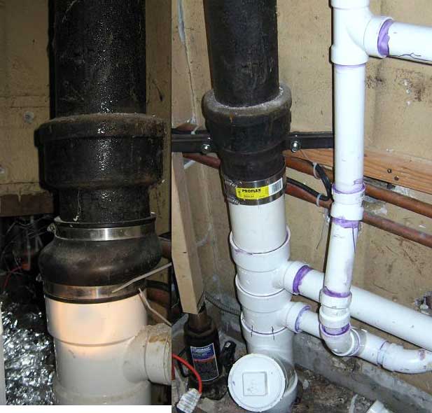

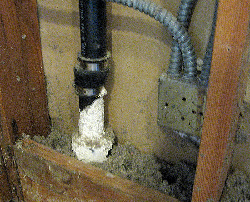

Pretty much everything I see there need to be cut out and redone.
Wrong fittings everywhere, wrong coupling where you change material, wrong layout.
The line to the tub has no grade, it should rise at 1/4" per foot.
Vertical to horizontal, a long turn 90.
Horizontal changes of direction, long 90's or 45's
The Fernco needs to be a shielded coupling to prevent future sagging, which does happen. Over time those things collapse.

The metal wrap keeps the connection from sagging.

You can use a 4x3 or 4x2 flush bush in a Fernco fitting.
I'm looking at all of the piping in that room.
I also see that you're using water fittings and not DWV fittings in places.
