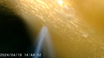

How can I repair our water well? The steel casing has developed a leak, even though the well was drilled just 14 years ago. Repairing it will be expensive, but I need to fix it, because it is the source of drinking water for our home.
Recently we noticed grit, and sometimes mud, accumulating in our whole-house water-filter canister. To diagnose the cause, I bought an endoscopic camera on Amazon. Using that, I discovered a quarter-inch leak in the steel casing, at about 40 feet underground. See the attached photo. Through that leak, water is pouring into the well continually, even in dry weather.
Three solutions have been suggested to me:

The 5" PVC casing from 90' to 220' is what I would call a liner. Too bad they didn't just line it all the way to surface and seal between the 5" and 6" to 103'. Not much room between 5" and 6" casing to make seal though.
The local well driller may know how to do this. I think you would need to pull the liner, add 90' to the top. and set it back down. There maybe some kind of seal they could wrap around the 5" at 102' to keep cement and/or bentonite from passing, which could be used to make the seal needed.

While a normal 4" pump will fit in 4" casing, it is a tight fit. This can cause problems down the road. But at that depth you can use a 3" pump like the SQ, which should work fairly well. You should have enough room to install 4" casing to the bottom if the well doesn't cave it when pulling the 5", which is a real possibility. If it caves, it could probably be drilled back out. If there is enough annular space between the 4" casing and bore hole and/or 6" surface casing, you could gravel pack the lower section to well up into the 6" steel casing, which would keep the cement needed to seal off the hole in the steel casing from going any deeper. But you will need a good driller to go along with a plan like that. :)

Here’s what we ended up doing: The driller lined the well with a 4-inch PVC pipe down to 90 feet. That’s where the existing 5-inch liner starts. At the bottom of the new liner, he installed two shale traps. One would probably have been sufficient, but I requested two, to decrease the odds that any bentonite would leak past and get into our well water. Finally, the driller used bentonite to fill the annular space between the new PVC liner and the existing steel casing.
The top of the new 4-inch PVC liner is positioned just below the pitless adapter. That allows the drop pipe to go down inside the new PVC liner to the pump. The pump is hanging about 160 feet below ground level, inside the existing 5-inch PVC liner.
Before the repair work started, I raised one concern with the driller: The new 4-inch PVC liner would be only slightly wider in diameter than the pump. So next time the pump needed to be pulled out, it could get caught on the bottom edge of the new PVC liner.
To avoid this problem, the driller used a grinder to bevel the bottom inside of the new 4-inch PVC liner. I requested that to make it easier to pull up the pump in the future. In other words, the slight flaring effect of the bevel might help to funnel the pump into the 4-inch pipe, as the pump is being pulled up. Whether that actually helps, we'll find out next time we need to pull up the pump for replacement or repair.
Anyway, several days have passed since the work was completed, and our water has become clear again. So apparently, the repair was successful.
