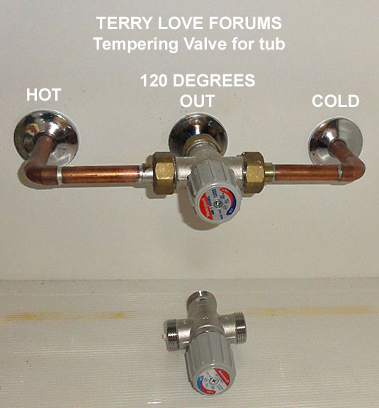

I need an ASSE 1070 compliant mixing valve at point of use for a free-standing slipper tub supply (3/4" supply lines btw). What products are recommended? The supplies are to be floor-mounted; how have you handled access for the valve in this scenario (I am thinking about building a box above the floor onto which the free-standing supplies can mount and within which would be the valve... other ideas?)

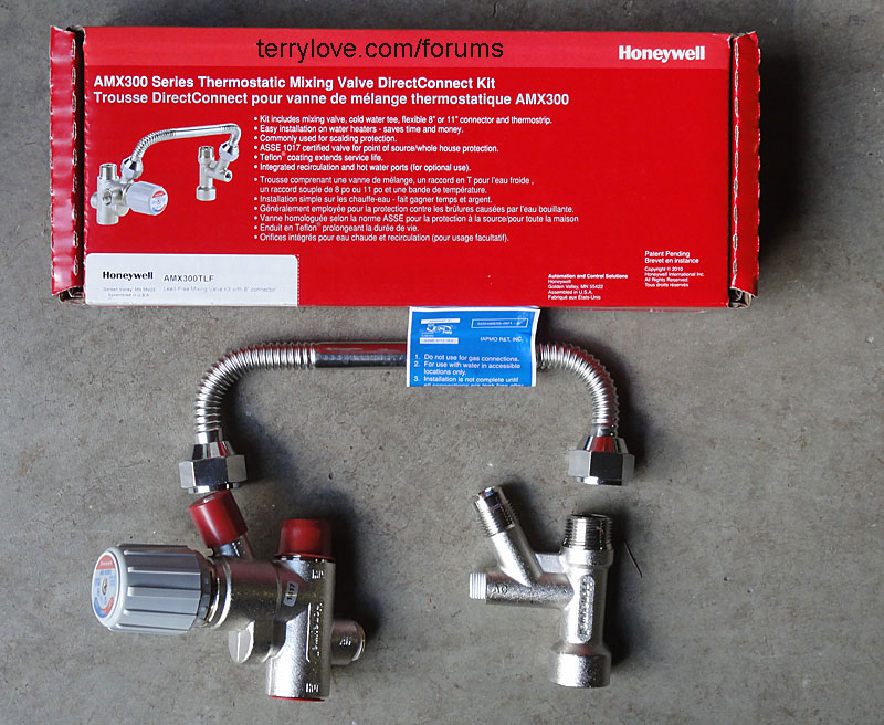

If your water heater is set to 120 with a tempering valve or tankless, you're fine as far as I know.
I like the tempering valves in the home, because it measures incoming hot and blends it down with cold.
Or just for the fixture. This one is located near the tub under a cabinet.
