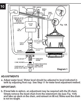

Hi Guys,
Ive got the flush valve for this champion toilet,
i seen where it was building calcium,
it was the tower on the left side
not the flush tower,
I saw all this calciium under the grey colored tower with the rubber donut on it,
It seems like the tower worked better,
and the water didnt go down when all this calcium came out of the fill tower on the left of tank,
can you get a fill tower on warranty,
heres my number off toilet, 4260,
I about give up on this thing,
I dont know where the water is going?
theres no bubbling in the tank,and I cant see anything going in the bowl,
it goes down really slow and then compensates filling up again about every 20 min's,
K Conway
1,193
Put some food coloring in the tank. Shut off the water supply. The tank will empty, and you'll have colored water in the bowl 999 times out of a thousand. Choices are repair or replace...ideally, not with another AS product!
