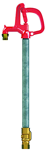

I sometimes use a yard hydrant. This one is galvanized steel.
Kinda looks like this.
Also copper works fine if you aren't in a freezing zone.
I use the yard hydrants in the Seattle area because the shutoff is in the ground below the freezing level.

Thanks Terry. I've seen those, but they are quite expensive it seems.
If I do galvanized pipe, are there PVC to galvanized fittings like those of PVC to copper? And is there any concern of putting on top of the galvanized pipe a brass spigot? I know sometimes dissimilar metals are not supposed to be connected in certain situations. But that is about all I know.
Otherwise, with copper, is there thicker walled pipes or even brass pipes available?
