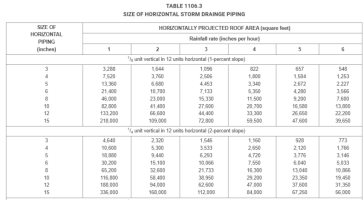

2021 IPC changed Table 1106.2 Storm Drain Pipe Sizing from roof square footages to gpm. The new chart allows significantly greater flows, yet I haven't seen this mentioned anywhere.
e.g.
The 2012 IPC (what we use for Indiana) has a 4" horizontal pipe at 1/8" slope capable of serving 2,506 sf with a 3" rainfall rate/hr. That code also includes the equation gpm = 0.0104 x R x A, where R = rainfall rate and A = roof area. Doing the algebra, that has a 4" pipe capable of flowing 78.2 gpm.
The 2021 IPC table has the same pipe size and slope capable of 115 gpm. 2021 IPC 1106.2.1 has the same equation GPM = R x A x 0.014. Doing the algebra there and it's saying that pipe could serve 3,684 sf with a 3" rainfall.
I realize that roof drain manufacturers changed their engineering info to gpm's, and that's perhaps the reason for the code change to gpm's, but I haven't seen anything to explain why they changed the allowable flows for the pipes.
