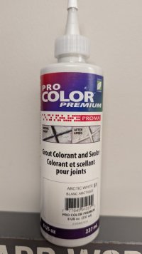

Why are the same grout lines in our shower tile floor breaking down?
stompy
Toronto
Certain grout lines are repeatedly failing (cracking, soggy, bulging, disintegrating) while all the other grout lines remain solid and never fail.
Refurbishment steps I take:
  • I use a grout tool to remove the failed grout, all the grout between the tiles
  • Using a puddy knife, I’ve pressed paper towel into the opening between the tiles to wick the water. The paper towel will remain damp for at least a week, but I leave it this way for a month.
  • I’ve built some thin piping / duct work to blow hot air from the furnace duct directly into the opening between the tiles (as the grout has been removed), and I’ve let it blow air for another month.
  • Before regrouting, I thoroughly clean with a brush, vacuum and wipe with solvent.
  • I use a fine sanded grout mix to re-grout as recommended by a tile specialty store, and then after a few days apply grout sealer.
  • Lastly, I replaced the caulking around the base which I’ve removed prior to regrouting (which was in excellent shape to begin with).
Within a year, the grout has failed again and I start the process over.
This problem has been ongoing for 7+ years. There is no indication that water is leaking outside the shower stall or shower pan.
Unable to determine what is causing this and debating if I should try to repair again or have the shower replaced.

Joint smaller than 1/8" ? Are they sealed?
Appreciate your question. I just measured and I all joints are just a hair over 1/8" (3-4mm).
I used "Pro Color Premium" sealer (picture of which is shown in my post) provided to me by a stone and tile specialty store. This sealant, unlike the sealant I'd previously used from Home Depot, goes on white and remains white, so as to confirm total coverage. I cleaned the grout with a hard brush + vacuum before applying.
