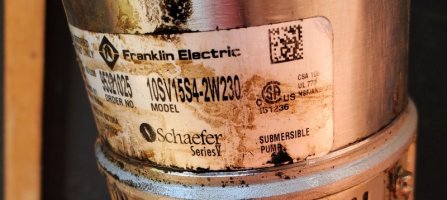

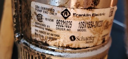

My well pump went out on me tonight. It's a Schaefer 10SV14S4-2W230. Well was dug 9 years ago before I bought the property. Was just used for cattle waterers. I have since put a home on site and it is right about 1300 feet from the well. I'm pretty certain the water lines are 1" poly pipe since the excess was left after purchase. Over the past couple months a few times I could tell the water was weaker than normal. I included the well tags for any help they may provide in helping select my next pump. I have 13 water points in the house. Household members like voluminous and higher pressure showers so water volume is preferable. Not against having a booster pump at the house for a steady 60psi.

The pump model number you gave is for a 10 GPM, 1HP. But the tag on the casing says 1.5HP. A 1HP, 10 GPM pump would be fine for what you have, but not the 1.5HP. I would use a 20 GPM series if I went with the 1.5HP. But I think the 1HP will be more than you need. You don't need a booster as that pump will build 190 PSI. Just need to be able to supply a strong constant 60 PSI as needed. Working with a 50/70 pressure switch the CSV1A can be set to deliver 60 PSI constant.

I forgot to include a picture of said pump. Should I go back with the same pump or look to a 15gpm? Or 20gpm as you mentioned? Also given the distance from well to house that's roughly 15psi pressure drop?

Your power wire might not be sufficient for a 1.5 HP pump. Might be. You could check that if you want more HP.
One thousand feet of 1 inch pipe will drop about 30 psi at 10 gpm and about 8.4 at 5 gpm. So if your pressure switch is at the well, your pressure at the house will vary more than if the pressure switch was at the house.

You are already running a 1.5HP, so the wire must be large enough. Yes, I would switch to a 20 GPM pump end if staying with the 1.5HP. The 20 GPM pump end will deliver more flow and less back pressure on a CSV. It will still build as much pressure as you need. If you are losing 15 PSI in the underground with no water running there must be some elevation as well. As was said, friction loss is dependent on the flow rate. With a 50/70 switch and constant 60 PSI from a CSV there should be plenty of pressure at the house. But if there is 35' elevation (15 PSI lose) you can turn it up to 65/85 and set the CSV for a constant 75 PSI, then you would have 60 PSI at the house.

A 1.5 hp 20 gpm pump makes less pressure to overcome the pipe loss than a 1 hp 10gpm pump does. Pipe friction loss and rising altitude losses add.
A 1.5 hp 10 gpm pump could make more pressure, and you could have a PRV (pressure reducing valve) at the house. That way, flushing a toilet etc will not change the flow at the shower as much.
If it turns out that the 1000 ft of pipe is bigger than 1 inch, that would reduce the friction loss factor.
