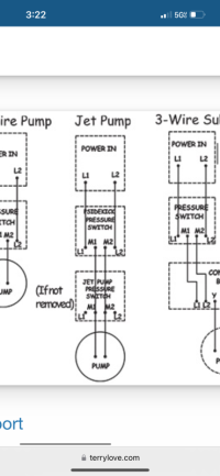

The jet pump is wired 115v and like the first diagram attached.
I seem to have good voltage ~115v at pressure switch on tank cross.
Yes I have a pressure switch with a lever. When I try to “restart” the pump, the contact close and just spark, but no pressure builds up/pump does not turn on. However, I jumped into the well pit and felt the motor casing warm to the touch.
Current is around 60 amps when I try to run the pump.

Might have picked up a stone and the impeller is jammed. 60 amps is a short But that exceeds its lock rotor rating. Absolutely sure it's wired for 120v and a single pole breaker is used?
With power off at the breaker, remove the rear cover and try to turn the motor shaft.

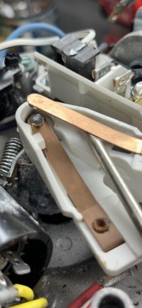

Never sand contacts at best take a business card run that paper over the contact on like a low amp relay.
I used to use a fresh $20 bill for contacts-- insert the bill, close the contacts, and drag the bill.
Koches
Parkton, MD
If you sand on contacts much at all you will ruin the thin silver coating.
Shoot. I took a wire brush to the contacts. Guess I should buy a new switch now…here is a before picture:
