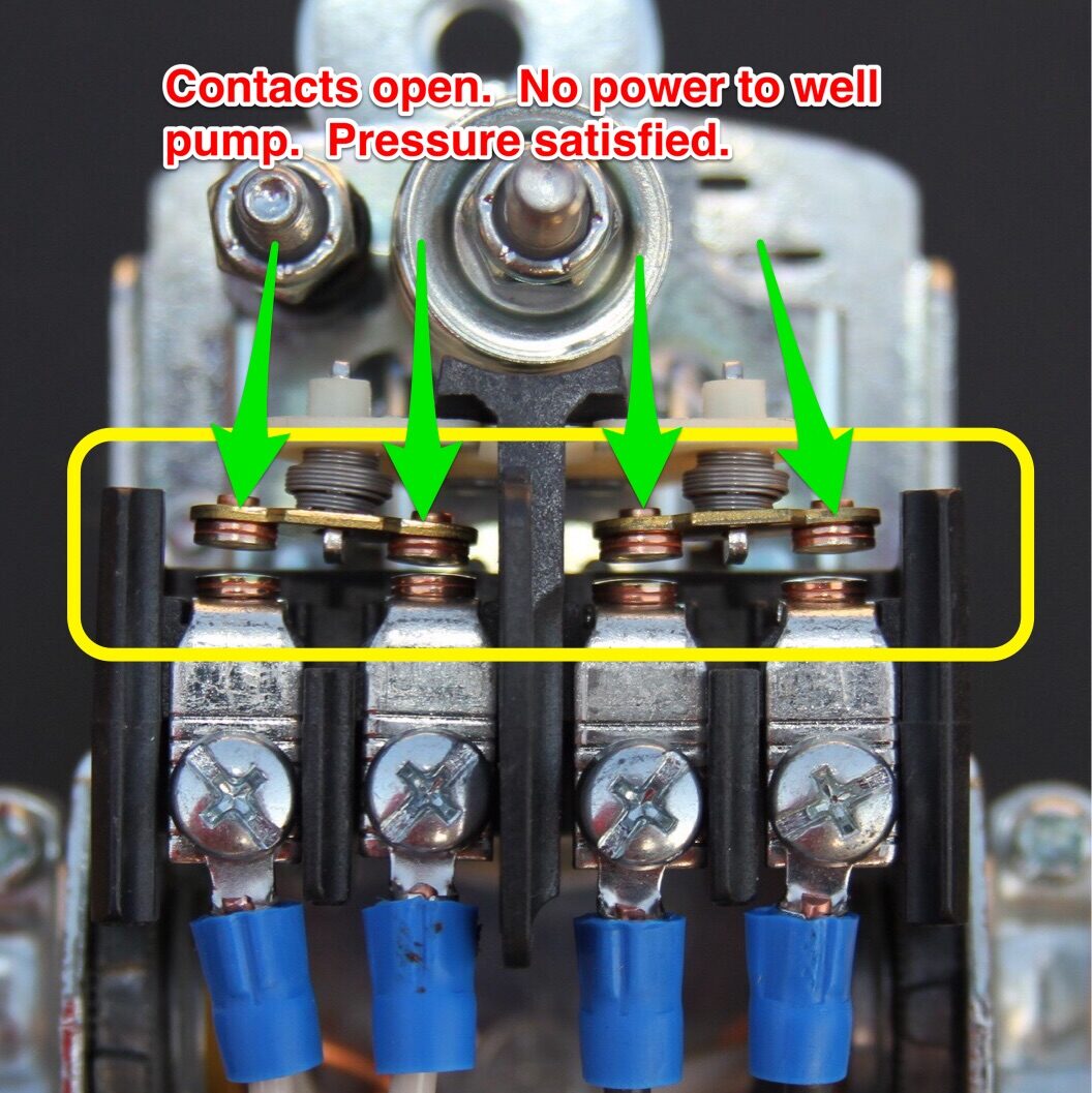

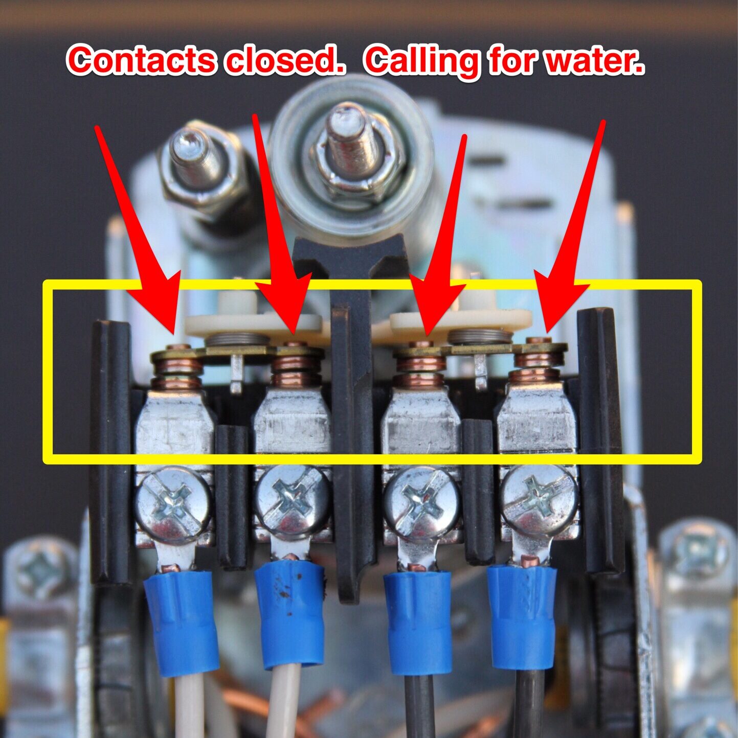

Does your pressure switch have a lever on it?

Examine the switch closely comparing it to the pictures that Bannerman posted paying close attention the spring action on the contacts. The springs should be fully compressed when the contacts are closed. Also, watch the contacts to see if there is a slight "wiping" motion when they close. Do not manipulate the arms that hold the contacts while testing but rather apply pressure to the plate that is moved by the diaphragm.
When the contacts appear to be closed but the pump does not run, check for voltage on the M1 and M2 motor leads to see if the contacts are actually closed.
My guess is the metal frame holding the contacts got bent and now the contact force is inadequate. I had a ham-fisted mechanic change the pressure switch on my work truck and he bent the frame while installing it in tight quarters.
