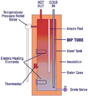

Are both the incoming cold and outgoing hot plumbing connections located on the top of the WH? If so, there will be a dip tube that should be installed in the incoming cold connection, to deliver cold water to the bottom of the tank without mixing with the lower density hot water above.
The low temperature exiting the WH will normally suggest a broken or missing dip tube, but your reference to water exiting from the outlet almost immediately upon opening the cold fill valve, suggests either the hot and cold connections are reversed as Sylvan questioned, or the dip tube was incorrectly installed into the hot water outlet instead of the cold inlet.
If the cold water inlet is located on the side, near the bottom of the tank, with the hot outlet located on the top, no dip tube will be utilized.

By this, the only way any water could exit almost immediately from the Hot outlet on an empty tank, would be from either the Hot and Cold connections being reversed, or the result of the dip tube being installed in the Hot outlet nipple. In either situation, the Cold water will enter directly at the top of the tank, with the water from the bottom of the tank, being pushed up the dip tube and out from the open 'Outlet' nipple.
