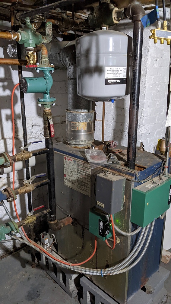

Existing Equipement in the house: 35+ year old Utica gas boiler for baseboard hot water heating and heating our indirect gas hot water tank year round.
This setup, has done a great job cooling our home, even in these recent heat waves. The PROBLEM: We are now experiencing carbon monoxide buildups in the basement. The boiler runs in these hot summer months to heat the water storage tank, and the addition of the minisplit system has definitely impacted the boiler venting. The boiler has its own doublelined flue that runs up from the basement, up through closeted areas on first and second floor, and pops out low on the roof line and extends another 10ft or so higher. Additionally, after installing the LG system, we were also seeing strong, continuous drafts being pulled down a chimney and out our wood stove. I was able to block that other flue effectively to stop that draft (and the chimney stench in the house).
Could we be experiencing that same issue with the boiler flue? That is, could negative pressure (?) created by the airhandler/return (?) be preventing the boiler from properly venting? Or some other theory? We NEVER had a CO problem before this system was installed, and the first time the basement CO alarm went off was within days of the install and initial usage.

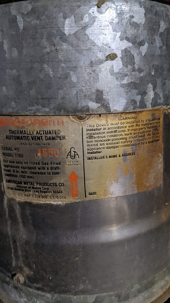

Turning to my boiler, I want to ask about the venting/damper setup. Is that something to look into as a possible factor? I'm not familiar with this style.

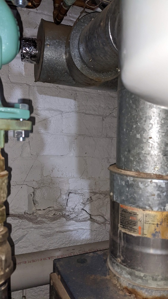

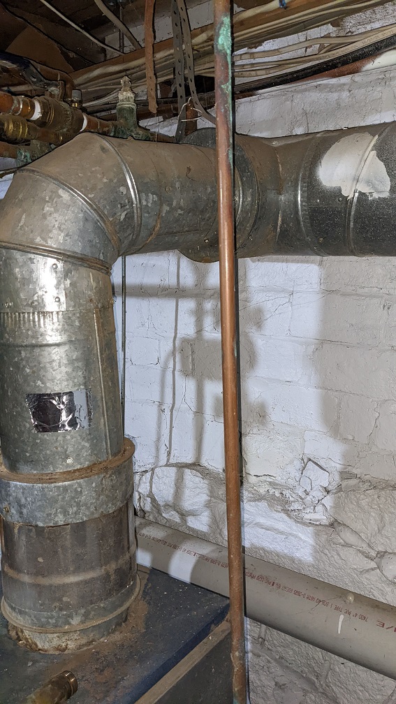

That damper doesn't use a actuator uses bimetal to open it. Unless im not seeing it. So boiler fires but it takes a few seconds for it to open when boiler flame is burning producing hi Co. Boiler side there are black marks on the flue pipe right off the boiler showing a leak. The bottom connection of the elbow looks like its short. The crimp is only half used. Pull the damper off replace with new flue pipe and adaptor to ell. Does the flue pipe get bigger going into the wall? A motorized damper on call for heat opens before boiler fires. Bi metal dampers usually have a place for a limit switch if the damper doesn't open trips limit burner shut off.

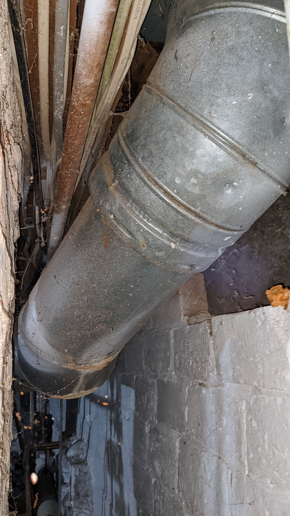

Thanks for the reply. Yes, flue pipe does get larger, as pictured here. So are you saying that a new (motorized?) damper might be something to mention when I get another local tech over here?

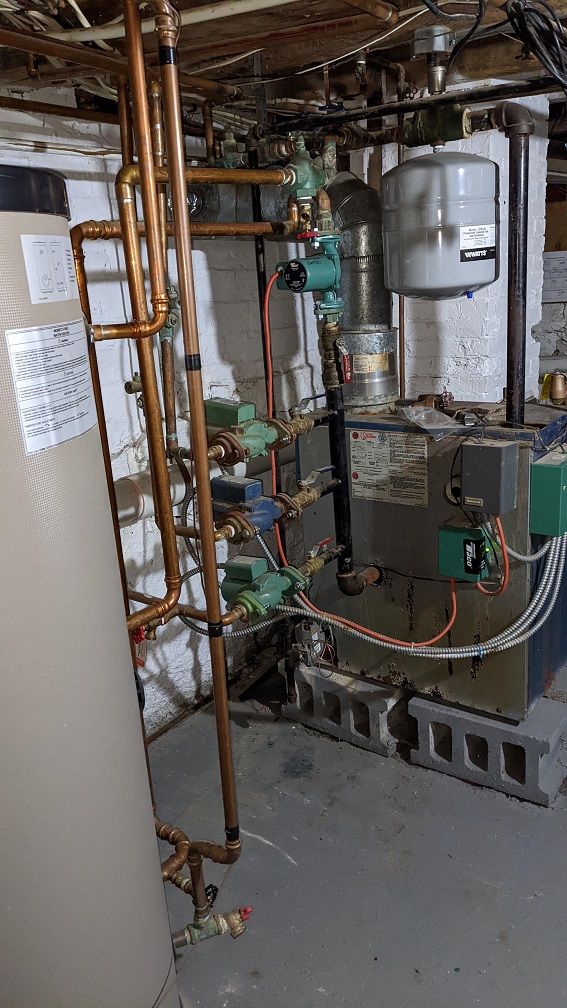

Where is the fresh air supply to this boiler?!!! Without that you'll always have C0 problems

Flue design shouldn't be lets guess. Know you heard this size matters. I want know btu input ratings and pics of other equipment flue pipe sizes and pics of equipment. Pics of roof where flue exits where flue to roof peak and where is the the flue over the peak best guess from the ground.

Just noticed the metal tape covering the old water heater connection back of boiler tee. That should be capped or changed out to a ell and get rid of the tee. Need the btu rating of boiler and brand and.model. That main flue going up and out what is the o.d.

I'm about 90 percent sure there's no makeup air to this unit and it needs a fresh air supply. It would be a shame to hire an engineer to say you need makeup air which is the simplest thing.
