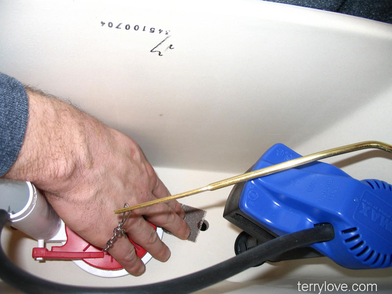

Sanding where the tank bolts go through.
If it's leaking past the flush valve, remove it and sand the inside of the tank.
Then reasemble the parts.

Many Thanks. I tried sanding the flapper valve gasket contact area in the bottom of the tank well, and then blocked up the tank, plugged the mounting holes, and filled it with water to test it. It looks like this cured the problem of the leak around the flapper valve body, so I reinstalled the tank. In a day or so I'll know for sure if I fixed the problem.

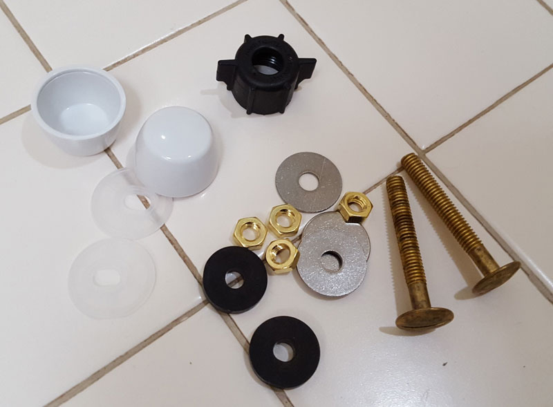

My Carrollton tank started leaking badly today. Installed in 2006. I guess I need to have replacement hardware ready, pull the tank, clean/sand/inspect, and reset. My question-- are these washers and gaskets, and the bowl to tank gasket standard items I can find at the hardware store? Or do I need to get everything from Toto?
3,481
Closet bolts are standard on tanks. For a 2006 toilet I would replace the supply line, and perhaps the fill valve too while you're at it.
Slide the rubber washer onto the brass bolt, drop the bolt in the tank and secure on the bottom with a washer and nut.
The next set of washers and nuts are to secure the tank to the bowl.

Thanks Terry. Extremely frustrated. I spent over 3 hours tonight struggling to replace tank bolts and tank to bowl gasket. Found a video that said to do bolt head/metal washer/rubber washer/tank/rubber washer/metal washer/nut; bowl/metal washer/wing nut. Leaked badly after the water reached an inch or so. Redid it --bolt head/rubber washer/tank/metal washer/nut; bowl/rubber washer/metal washer/wing nut. Same deal. I managed to crunch the bottom edge of the flush valve a bit-- tried to flex it back, seems too minor to create a seal problem, and if it did, it wouldn't show up with the flapper sealed..... wondering if I have the same problem wolcott above had? I've been looking at flush valve assemblies but mine seems to be discontinued and I can't determine with any confidence what would replace it. The

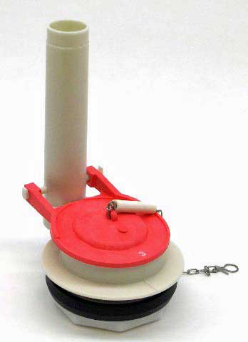

original looks like this:

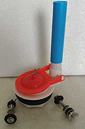

I've got this aftermarket dealie in my cart...
That says it fits 774 (which is Carrollton)- does that seem right?

K guys, I did establish that it was leaking majorly from the base of the flush valve. Couldn't budge the nut. I did order the assembly pictured above. It's in, and no leaks from anything-- except once the water gets above the level of the flapper it leaks through that opening. Am I correct that the flapper needs a little water pressure to push it down so it will seal?
Also, that blue tube (red in the one I received, more inline with other images of the part I've found) is an adjustable extension-- directions say to set it so the top is 1/2" below the handle hole. That would put the level much higher than before, and submerse the top of the fill tower. Is that OK to do?

All back together... leaks. Are we sure it takes a universal tank to bowl gasket? There's not that much thread exposed on the bottom of the flush valve.... when I look through past the flapper it doesn't seem like the spout of the flush valve is completely seating all the way around. And/or there's no way it's going to fit around the nut to be flush with the tank (like in your pic at the top.)
