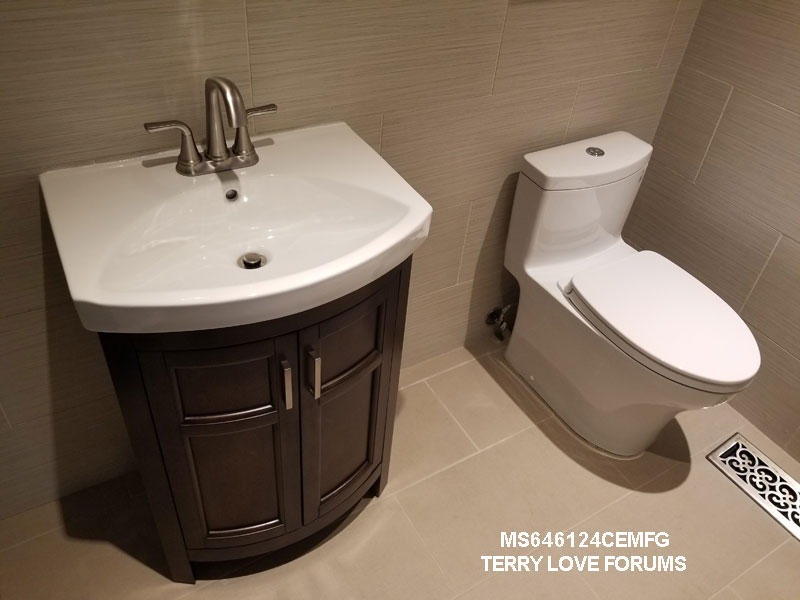

A delta faucet on the vanity.

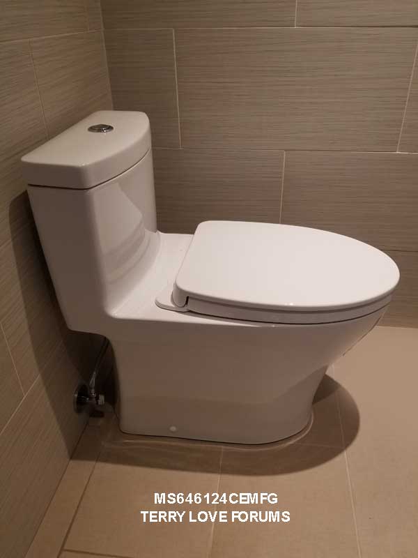

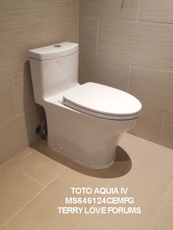

The little plastic dots on the side cover the securing screws that thread into the blocks.
The bowl is a T40 for a concealed Washlet connection. It uses the SS124 softclose seat and the additional toggles because of the skirted bowl design on the Aquia.

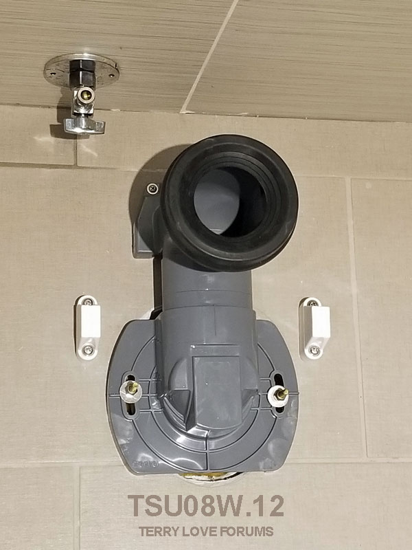

Mounts using the TSU08W.12 for a standard 12" rough. They also make adapters for 10" and 14" roughs.
It helps on tile to have several drill bits. I like to start with 1/4" and finish with 5/16"
I'm very careful with my rotohammer on tile like this.

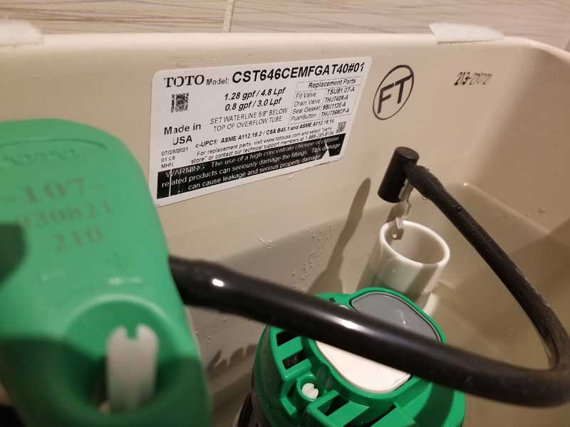

The Aquia bowl have very little water in the bowl. That is the factory setting for that. You can direct it into the overflow, but it won't matter.
Tuttles Revenge
4,205
1,460
Pretty certain I've always reconnected that tube to dump into the overflow.. oops.
The last E tank I did for a Drake came with the fill down the overflow tube, and the one before not. The one above might have been a mistake. I'm not sure.
I wondering if they're thinking that much at the factory. Next install I'm trying it both ways just to confirm what happens.
Normally we put the refill pointed down, but I'm seeing some things now that I know are mistakes.
Today I installed a Entrada, refill tube not directed down the overflow. Bow refill was not good. Moved to where I normally expect to see it, down the overflow and now the bowl filled properly. I think the factory is haphazard lately on fill tube placement. Now I have to check every time.
