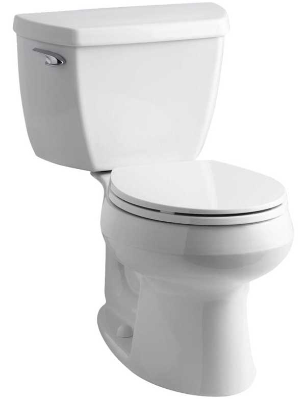

Standard height round at Home Depot? Kohler Classic Wellworth.
Kohler K-11464
And I sell a bunch of these, but not from a home center.
CST743E TOTO Drake
OFDPOS
24
Terry , which one between the two would you recommend ?
HD has the Kohler K-11464 in stock for $154.oo
Lowes ,Have to order the TOTO CST743E TOTO Drake but would be here in time .. for $223.94
(for some reason HD only shows the TOTO in Sedona Beige or Ebony Has to be white..
Looks like would have to purchase the seat separate with the TOTO .
3,481
The TOTO has a slight edge in flushing, though not a deal breaker by any means. For many it's about how it looks, and others how much performance they are looking for. I think she will be happy either way.
OFDPOS
24
Thank you , I'll go with the Kohlor since they have it in stock and if any concerns can have another one on hand instead of if ordered and there is a problem we won't have it in time.

Take a close look at the Kohler from the side and follow the waste path...Kohler tries to make it turn a sharp 90-degree turn into the drain. Toto rotates it in the toilet so the outlet is pointing nearly straight down into the drain. May not be a problem for everyone, but sharp turns slow things down and potentially, for some people, can be a source of clogs. There's a reason why Toto is one of the largest international toilet makers, making Kohler look like a small town outlet.
