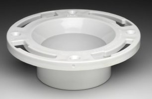

Reach, I swear there's a reducing fitting and that's where it's leaking. See the pic, I think it's a 3" 90 and an extra fitting to reduce the flange from 4" to 3". While possible to assemble that way, it creates an additional failure point right where there's the most flushing forces. :(

See how these two flanges are different? One is flared and one isn't. Maybe that's not a 4" - 3" on my flange, maybe it's all one piece except for the joint at the 90. I need someone who knows what they're doing! :)

Lee, the flange likely dosent need support as it is sitting on floor. but often not secured to floor and the issue is the flange is pulled up against toilet squishing all the wax out. Get under neath and push up on the 90 if it moves you got an issue

Good point. A major job of the closet flange is to hold the toilet down. If the flange itself is not held down well, that stresses stuff.
An alternative that takes the stress off of the flange itself is the Danco Hydro Seat is like repair ring with a tail. Use wax ring under. The screws thru or just inside of the legs take the lifting load.

blocks of wood screws and plumbers tape if wood is in good shape and access below is good. the danco flange looks good too for when wood or acess isnt so good
