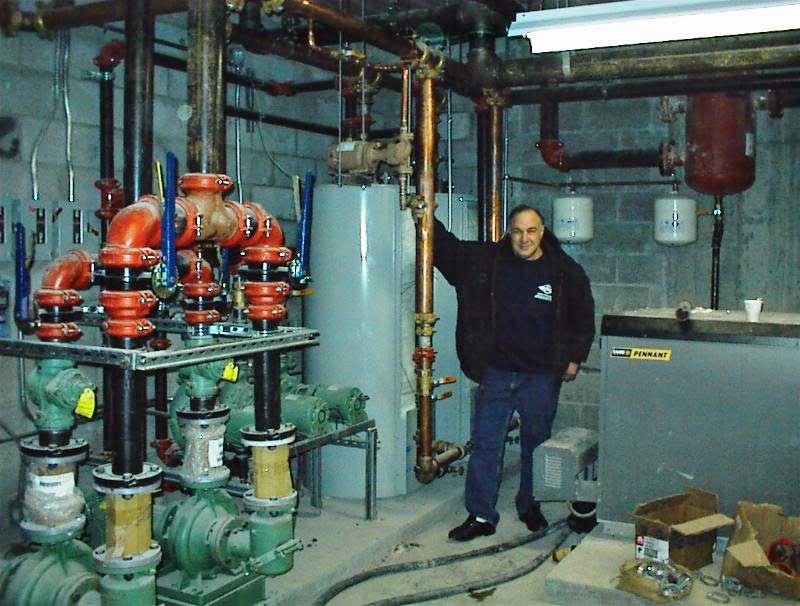

Actually my company does commercial, industrial, residential and institutional and boiler installations and inspections
I work as an expert witness going against unscrupulous land lords and inept plumbing contractors
My other company strictly fire suppression and the last major job we did was on the 86 floor of the Empire state building
From one family homes to high rise residential along with water Jetting line up to 30" and as small was 3/4"
Sewer and drain cleaning actually pays a lot more then "plumbing"
Now with the new gas laws in effect my partner completed the 32 hour classes and has a back flow testing certification
Not too shabby for a guy who came to America less then 6 years ago waiting for his citizenship papers
