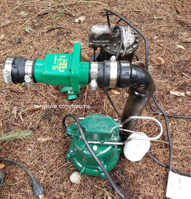

3,481
I would cut off the pipe at the P trap and extend everything to the right far enough to clear the plumbing. Then a standpipe extension can be added to the P trap to get it at a proper level. You still need an air gap.
Nothing will drain past the check valve.
This fitting goes on a pump.
