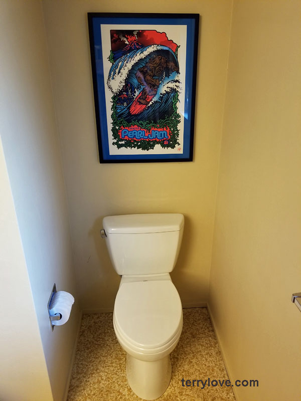

Putting a TOTO Drake together in Black (51)
Almost done.
Ready for some clear caulking at the floor. I like taking the pictures before I do that. The caulking I use goes on white and dries clear by the morning.
Okay, why not a white one in the other bathroom. Sure.

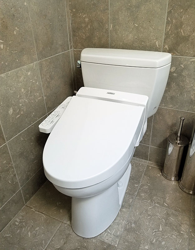

The Drake CST744ER with the right hand tank lever. An older 1906 Seattle home, in the basement and rough plumbed right against the wall to the left. Replaced the leaking shutoff valve in the corner while I had the old toilet out.
3,481
Installed Thursday in Bothell this week. Pulled out a Mansfield 160 that came with the house.
A nice upgrade for the kids in the home.

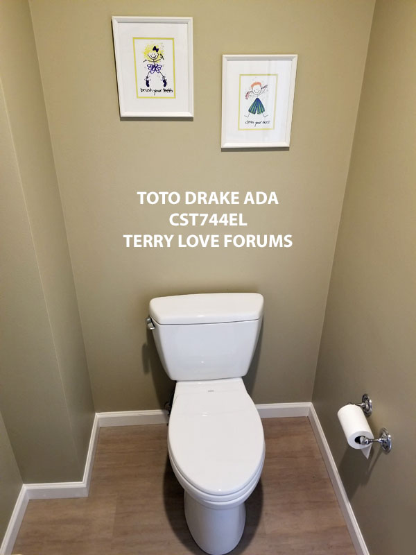

The CST454CUFG Drake II is very nice.
That being said, the CST244EF Entrada is good, and so is the CST744EL Drake ADA.
