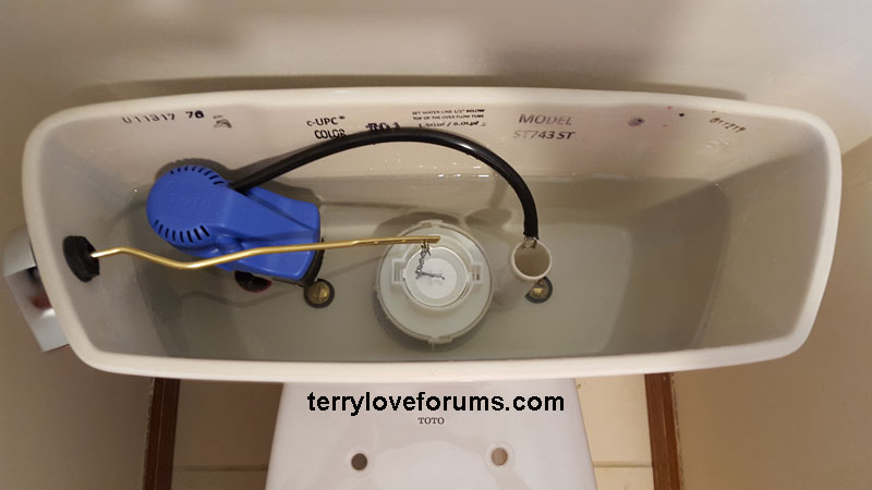

I installed the CST744E 1.28gpf Drake this weekend. Finding a wooden elongated seat that fits flush is my next order of business. At 14+5/8" I find the toilet a little too low, much more preferring my ADA Drake 1.6gpf. The Kohler plastic seat is 3/4" thick while the Bemis was 1+1/6" thick. That would have bought the seat height to 15+11/16, a little shy of the 16.0" I think would be ideal.
The 1.28gpf seems to the job. But the shorter Drake doesn't have the same "feel" when it comes to doing a quick handle jiggle to flush half a tank. It seems as if I have to be very careful not to give it a full flush, a full lever depression, the same as when I was using the Briggs. Too short a stroke and it doesn't flush at all. (One thing I learned was if the 1.6gpf didn't half flush I had to wait a couple of seconds before trying again. The one time I didn't wait it spit water up and out of the bowl.) Even at work I try to "cheat" the flush so that I only use as much water as is only absolutely necessary to flush urine. To me, not being able to do a half flush means that I will actually be using more water than when using my 1.6gpf Drake.
Wallijonn
335
15
Arizona
I installed the CST744E 1.28gpf Drake this weekend. Finding a wooden elongated seat that fits flush is my next order of business. At 14+5/8" I find the toilet a little too low, much more preferring my ADA Drake 1.6gpf. The Kohler plastic seat is 3/4" thick while the Bemis was 1+1/16" thick. That would have bought the seat height to 15+11/16, a little shy of the 16.0" I think would be ideal.
The 1.28gpf seems to the job, as far as flushing solids go. It has a wider water spot than on the 1.6gpf Drake, almost diamond or square shaped. But the shorter Drake doesn't have the same "feel" when it comes to doing a quick handle jiggle to flush half a tank. It seems as if I have to be very careful not to give it a full flush, that the handle only seems able to do a full lever depression, the same as when I was using the Briggs. Too short a stroke and it doesn't flush at all. (One thing I learned was if the 1.6gpf didn't half flush I had to wait a couple of seconds before trying again. The one time I didn't wait it spit water up and out of the bowl.) Even at work I try to "cheat" the flush so that I only use as much water as is only absolutely necessary to flush urine. To me, not being able to do a half flush on the 1.28gpf Drake means that I will actually be using more water than when using my 1.6gpf Drake.

A push and release on the tank lever lets out the metered flush. This is how it's meant to be used.
With the S tank, thats 1.60
With the E tank, that's 1.28
Holding the handle down, drops the entire tank, which may be about 3 gallons. You can do that, but you surely don't need to.
Before flushing any bowl, you should wait until the bowl has refilled. Siphon depends on a full bowl before you start the flush.
We never resort to Silcone for any part on the tank or tank to bowl. We install hundreds and hundreds with "clean" parts.
And our customers do too.

I don't get all the posts regarding messing with how one flushes a toilet. It's simple on the Drake. Push the dang thing swiftly but not violently to the full length of its travel and immediately let go. That will ensure that the flapper gets fully-open and then will promptly slam shut after dispensing the right amount of water. It's possible to "misfire" the flush if you don't push it all the way, but once it's there you let go right away.
That's what I did in this video, and it shows properly how it should work. Note that the flush handle has been returned to rest well before the flapper starts to close, even though the flapper shuts quickly:

I'm the guy who had a leak at the tank bowl seal. After three tries I gave up and bough the Korky 481BP which immediately fixed it the very first time. I didn't want to play games with the second Drake and my local Ace Hardware and HD did not have any 481BPs in stock. Since it's plumber's 100% silicone I know that it will not harden. Well, at least the stuff I bought. I hope that it doesn't attack rubber like Vaseline does. And if it does I'll just pick up a 4811BP kit for under $10.
Sure. But the fact that one can do it on the Drake, it is a benefit. My water bill went down. That's all I know.
41,332
4,982
Well, at least the stuff I bought. I hpe that it doesn't attack rubber like Vaseline does. And if it does I'll just pick up a 4811BP kit for under $10.
You had said "plumber's silicon glue" when you meant "plumber's silicon grease". The grease is not a problem, even though it was not required, and it will not attack rubber as Vaseline would.

The "jiggling" of the flush lever now seems to be working right. The fist time I flushed it seemed to flush more than 1/2 the over flow tube's length; now it seems to flush about half. (Not hard to see since there always seem to be small air bubbles attached to the outer circumference of the overflow tube.)
I decided to go with the Toto SS154-01 seat since the spec sheet lists the seat height as 1+1/8", which should bring the height up to 15+6/8".
Still no leaks whatsoever. I guess the plumber's silicon grease did do the job. I just don't trust the black tank to bowl seal that comes with the Drake toilets, and the red seal is thicker than the black, so it may present problems to others. Plumber's silicone grease is known not to attack rubber, usually being used to grease o-rings. I use it to coat fixture threads to prevent mineral build-up.

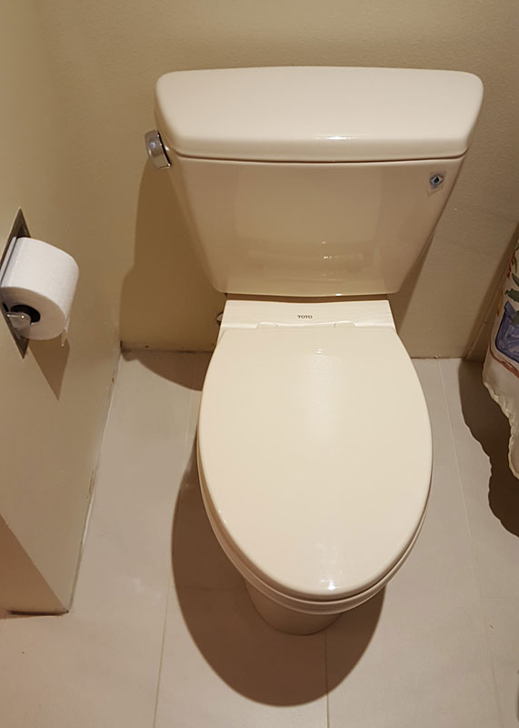

SS154 is in. Both the top and bottom soft close, just as Terry said. Even fully tightened the bolts will allow some seat side to side play. I would have preferred a completely smooth top, but I will learn to live with the scallops. The seat surface is concave. I will have to get used to that too, but I don't find it objectionable.
Having now installed both the 744EL (shortey) and the 744SL (talley), the ADA height Drake definitely looks sleeker, like a sleek race car. I know it's just an illusion, that when seen at different angles (say, sideways instead of straight on & down) they seem different, but the 744EL just looks smaller, shorter, slimmer, and part of that illusion is the toilet seat, with the Kohler seat making the 744SL look sleeker. The Kohler seat has about the same overhang as the SS154, about 1/8".
No, it is not an illusion. When measured from the top of the tank to the floor the 744EL is about 3" shorter (it's actually 2" shorter.) The SS154 seat just makes the shorter toilet seem chunkier, it sticks up much higher than the Kohler seat. I guess there's no pleasing me...
If others are considering either it may help to take into account the cabinet heights already in the bathrooms.
My two bathrooms:
744EL - 29" High
Cabinet - 31" High
744SL - 31" High
Cabinet 31" high
Next up for me is to find a taller vanity cabinet for the master bathroom since I find myself bending over too much, too often. My friend had mistakenly installed a kitchen cabinet in his bathroom, and I loved it. I would have no problem installing a kitchen cabinet in the bathroom since it would mean that I could install a hand-held side spray for shampooing and wetting one's head (we tend to over heat in our AZ heat and dosing our heads under a faucet helps cool us down); a taller faucet would help when rinsing my mouth with my hand palm. A full master bathroom renovation is not on the schedule at the present time, maybe I'll do it in a few years...

You and Terry are absolutely right. When I first got the Drake I would hold down the handle for about two seconds. Now I just go all the way down and release. I guess I had to break the bad habit I formed when trying to flush the 3.5g Briggs, where it took two flushes to fully clear the bowl (and I would hold the handle all the way down to make sure that every last drop of water flushed the bowl.) At work I find myself not wanting to flush the Eljer all the way down (it has a really long handle trip distance), even after the maintenance guy has it set for about 0.8g (5"x6" water spot) I feel that too much water is going down the drain. I figure the siphonic Drake does the same thing (but the bowl flush time is a lot longer on the Eljer - making it seem that a lot of water is being flushed), and I now find that my fears have been allayed, I have found that the 1.28g Drake is just as efficient as the 1.6g Drake (I feared that 1.6g would be most efficient and the 1.28g wouldn't be good enough (because my friend's Kohler 1.28g flush was bad.) Yep, I'm convinced on all accounts - siphonic flush, lower water usage and smaller water spot. I had my doubts, but when Terry says that a 1.0gpf is good enough - it most probably is - so long as it's a Toto. I won't trust anything else. Knowing what I know now I would have no hesitation installing a 1.0g Drake.

A TOTO Drake elongated with a new tile floor and neoangle shower.
This one is in West Seattle.
