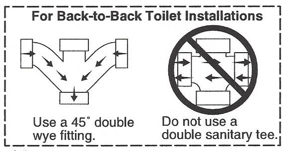

Snaking with back to back toilets, be careful people! Sometimes the fitting between the two bowls allows the snake to skip across the fitting, and come up the other side. Here is an example of that.
This can also happen with back to back sinks or lavs, though not as serious as something like a broken toilet.

A better way to plumb back to back on the left.

I was called out to a job to assist our service guy who was having an issue clearing a drain.......This is what I found when I arrived.
The broken toilet is in a separate unit across the hallway. When he ran the large cables they went past the vertical, into the next unit and up the toilet..... smashing it to pieces. Along with marking up the walls and baseboard, the head of the snake dug a hole into the tile!
After clearing the drain we sent a camera down to take a look. We found that both of the units were connected to the vertical with a double Tee.
