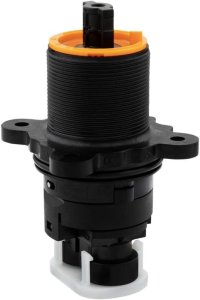

Second issue is with respect to the valve body itself. You can see from one of the attachments that there is some erosion on the cold side opening where the D-shaped o-ring sits. When I took out the old valve, the o-ring and the plastic channel in which it fits were deformed.
Thoughts on whether or not this will operate ok once I replace the cartridge?
Third issue is with the Pfister replacement cartridges. They had sent me part 974-042 (or 974-0420, gray one pictured) which has the same general shape and mounting configuration, but is a one-piece versus the two-piece cartridge I pulled out. When I went to put this in, it didn't quite fit; the external sealing o-ring didn't fully mate with the valve body. I didn't want to push it too hard, or drive it in with the screws, because I was concerned it was the wrong part. Called them, and they said this part is obsolete, and they are now sending me 974-5319 (black one pictured).
Does anyone have a good understanding of the Pfister replacement cartridges to be able to provide some guidance? Are these all the same, and do they replace the two-piece valve stem and pressure balancing cartridge I have? Any reason i couldn't get the gray one to fit properly? Looking around the internet, I've noticed some valves with D-shaped seals on the inlets, some with O-shaped seals, two piece, one piece... I've seen mention of 0X8 valve "deep castings", etc. It's very confusing. Just want to try to identify the correct replacement so I can look for it locally to get this back up-and-running.

For those who come across this in the future, 974-5319 was the correct part number. In the picture below, there is a white adapter piece on the end of this part which has the D-shaped o-rings, which can be removed for a valve with the O-shaped ones. I believe this allows for backwards compatibility with multiple style valves.
It didn't go in as easily as the one which came out, probably because the sealing o-ring is brand new. Needed a bit of a push to get the o-ring to seat. I thought I had the wrong part again, because this is the same issue I was having with the gray one (974-042). I suspect the gray one might have actually worked fine as well if I gave it the same push.
