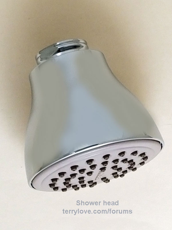

I would change the shower head.
I have installed new ones that had a high pitched whistle. Sometimes I take a drill bit and make the hole slightly bigger where the water enters. Changing the diameter of the hole changes the sound. If the water has to pass through too quickly, it can make a high pitched dog whistle like sound.
If the noise is still there, post back.
I sometimes drill a hole in the aerator to change the tuning of the head. A larger hole changes the speed of the water passing through.

You could just take the head off and listen. While you have it off go ahead and clean the head.

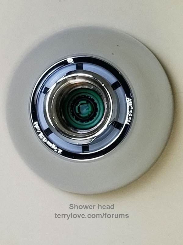

Thanks, all, for your feedback. I finally phoned Delta and was told the shower head needs to be replaced. They said the whistle doesn't occur when either just cold or just hot water comes out because there is less pressure than when both pipes are being used (that was verified by taking the shower faucet off and observing the water flow at different temperatures).
The guy I spoke with said the problem lies with the small knob on the side of the faucet that controls whether the spray is fine or coarse.

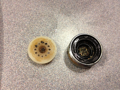

I have fixed some noises that seam to come from the water aerators - they get little bits of crap in them and then make a whistle like sound. These have been simple changes and have once even had it in a clients toilet.

Blocked Aerator
