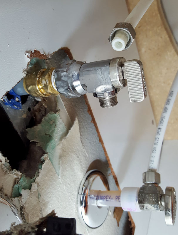

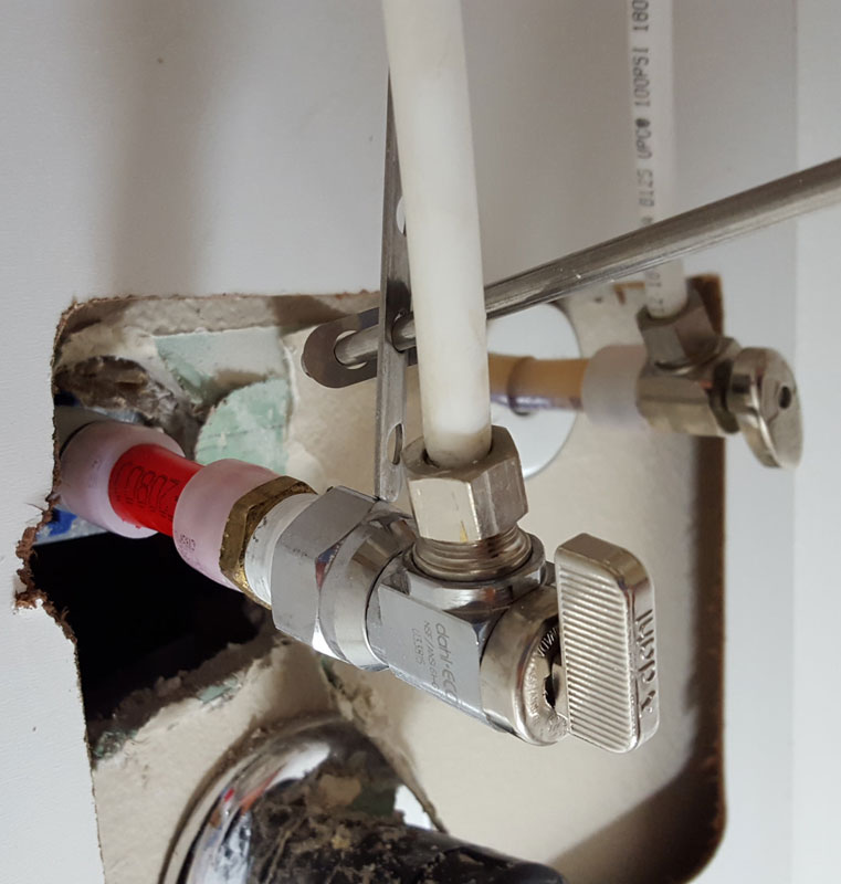

Okay. Sometimes it happens. I got a call from a homeowner in a highrise condo that had a repair done by another company and it was still leaking.
No. I wasn't this company, but it could have been someone like this. I love this. A plumbing company that is just Okay.
Normally you can cut PEX and push a Sharkbite on and you're good to go. You can see the water leak behind the Sharkbite.
Lucky for me, and I mean lucky. The PEX in the wall is the same stuff I carry and have tools for. I went ahead and extended the valve out a ways, and added a male adapter that makes changing the shutoff easier for the next guy. They guy I followed had a muti-turn valve which I replaced with Dahl. I do like 1/4 turn shutoffs.

I like copper stubouts with compression stops. I can remove and replace when needed.
The pictures above were done with male adapters which allows future replacements. Some of the contractors around here are using Sharkbite style stops on PEX, which can be a little harder to work with later on. Those are the new construction guys and they aren't doing service work.
