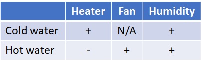

Thoughts on adding a second solenoid, plumbed to hot water, so that a bypass humidifier can run without the furnace (heat)?
Each solenoid valve would be plumbed to hot or cold water. The output would union before entering the bypass humidifier.
Ecobee thermostat set to "steam humidifier" would allow for humidity calls without the furnace. Logic controller or current sending relays would be used to activate the appropriate solenoid...cold water when furnace is on and call for humidity, otherwise hot water if furnace is off with call for humidity.
Overall goal is to run humidifier without heater, but reduce energy and drawbacks of solely plumbing to hot water.
Note: This isn't meant to be a forum on whether hot of cold is better; it's to figure out a method to have selectable.
