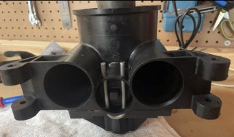

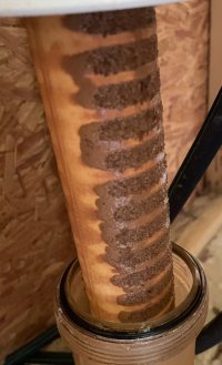

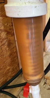

The photos:
1. A 50% tub day before adding the systems. Some days were dirtier…some less.
2. Leftover residue in the tub.
3. The Sediment filter (100 micron) after a week. we clean it each week To get it clear.
4. the filter screen. It’s very fine sand and the Iron Bacteria or basic iron in ferric state.
5 & 6. The inside of the Cleer system at 1.5 years.
7. After cleaning. With the new pack seal…it worked for a week…then they replaced the motor. At that time, it still looked clean/new…not like pic 5.

Your sediment filter appears to be undersized for your current requirements. Perhaps it may be suitable after the well is flushed, but another alternative is a back flushing sediment filter such as the Atlas Filtri Hydra. Opening a valve will cause the screen to be cleaned without removing the screen, and an optional battery operated purge kit is offered which will cause the screen to be purged automatically on a schedule such as daily.
When there is significant accumulation on the filter screen, I suspect flow to the Cleer system will be reduced and may not be sufficient to allow the Cleer system to fully backwash as intended. Since a large amount of particles smaller than 100 microns will pass through the 100 micron sediment filter, those small particles maybe accumulating within the internal components within the Cleer system, which maybe why the valve is failing so frequently.
