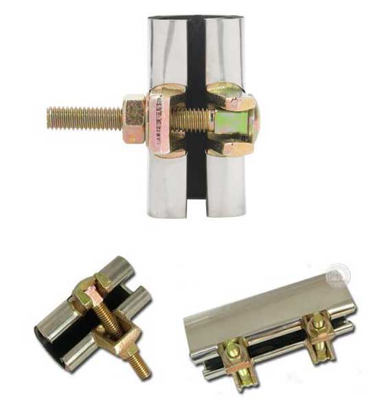

An optional "Quick Fix without fully cutting the pipe"
is to cut a slip fitting in half and create a saddle, clean and debur the saddle , solder the saddle over the small screw hole with the proper flux and solder.
They also make a "Powerseal Repair Clamp" type product for this but may not fit under the plywood properly.
