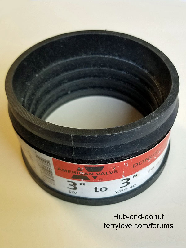

In the bath tub. In the concrete slab is a steel pipe going into a cast iron base. I want to replace this Steel pipe with ABS. This steel pipe has an outer lay or part of another pipe around it that rusted away. You can see what is left of the outside pipe at the base of the cast iron.
Should I remove the steel pipe totally? how would I do that. it looks like its welded in or something. I don't see any threads
Also if I cut near the cast iron base and put a fernco. Will the steel not eventually rust away also?

If the steel is threaded, that's one thing. If it's leaded in, that's another. Need to know. Unless it's underground, you must used a banded coupler.

I've been there. The no hub type coupling did the job fine. It did not get inspected so I don't know if there would have been a problem. If you have to unlead the joint and fit a donut, the job is much more difficult and unpleasant. The small area of galvi remaining will last a long time in my opinion, if it looks ok now.
